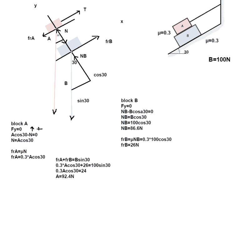

I have been given the weight of block B, an angle and friction coefficient
Fx=0
Fy=0
friction=μN
I tried to solve it via equilibrium equations and I got 92N for block A
What effect, if any, does the weight of ##A## have on the normal force between ##B## and the slope?
Well A should be the same force as N if I account for the angle that is N=Acos30 for y direction, right?
And N influences both blocks.
Okay, so what does that imply for calculating the friction between ##B## and the slope? I don't see it taken into account here:
So
N-Acos30=0
-N+Bcos30=0 -> N=100cos30=86.6N
A=100N ?
There are two normal forces that you need to evaluate. One is the force between blocks ##A## and ##B##, and the other is between ##B## and the slope.
The normal force between ##A## and ##B## depends only on the weight of ##A## as you've shown, and you've already realized that block ##A## will contribute to the net normal force between ##B## and the slope. What expression can you write for this second normal force?
