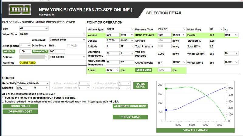

Here is a selection for the highest pressure blower you're likely to find:
180 inches of water gauge is 6.5 psi or an available pressure ratio of 0.69. That's a lot better than I would have expected, but still quite a bit above the maximum required for choked flow of <0.5. And it requires 170 horsepower for just 200SCFM of airflow. That's like a midsized car engine at full throttle to run a bathroom fan.
Oh! Is that what HVAC guys call a "blower"?

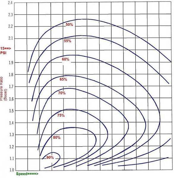

Try a Roots-type blower, you can achieve 2:1 pressure ratio easily:
Funny how we see different things from the same statement.

Wow, thanks, I hadn't heard of that. And it fits nicely into the nomenclature overlap, being referred to as a blower, a pump and a compressor in the same article! I would say that's confusing, but it really is in an overlap range: the flow is definitely compressible even though the pressure is below what is common for "compressors".

Actually, it is a simple "air displacer". The air gets into a chamber and the chamber rotates towards the outlet. If you put it in front a restrictor (ex.: an engine with a smaller defined volumetric flow), then the pressure will accumulate between the two, i.e. a compression. So it is in fact a «blower».
There is also a screw type compressor which looks a lot like a roots type, but it actually compresses the air within (the chamber decreases in size as it moves), so it is a compressor. That is why they are more efficient than Roots type.
