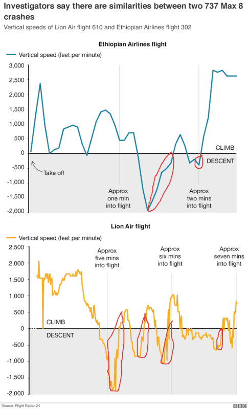

jim hardy said:
https://www.bbc.com/news/world-africa-47553174 red marks mine jh
https://www.physicsforums.com/attachments/240391
That would of been a terrifying ride.

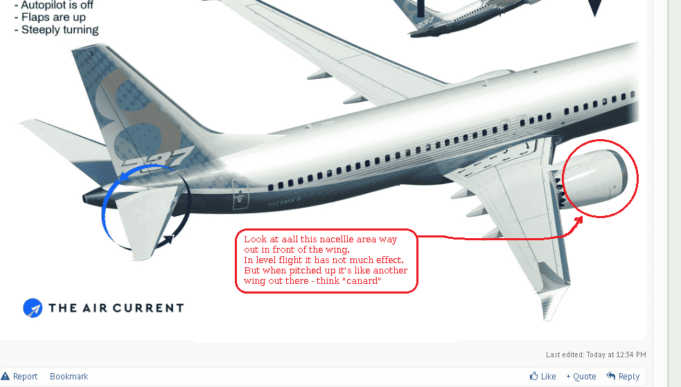

jim hardy said:
Yes Torques and moments are the terms we'll hear.View attachment 240387
You might think of that nacelle as giving "Positive Feedback" when changing pitch.
A bit of Nose Up input to the yoke makes the nose rise,
and that small nose up causes upward force on the nacelle which unopposed will rotate the plane even farther nose up.
That's what positive feedback does, it increases the gain of a closed loop.
It also changes its time response, a small change will keep on growing for some time**(see below)
So a pilot accustomed to the old plane takes off in a new one,
pulls on yoke with force that's always given him 10 degrees and gets maybe twenty and it's still increasing ,
were there no passengers he might exclaim YEE HAW what a ride !.
More likely he'll push the yoke back and if he overshoots level that could start an oscillation.
Honestly that's what i first thought when i saw those vertical speed graphs, PIO , but as Ernie Gann says it's too easy to blame the pilot.
So Boeing came up with MCAS to undo the positive feedback from nacelle lift and prevent that scenario.
they created some negative feedback via MCAS
A bit of nose down down from stabilizer will surely cancel out the nacelle lift, it's the right direction for negative feedback
If done well it should prevent that extra nose-up from ever happening in the first place,
as an old controls guy i would be worried about the relative speeds at which yoke input moves the elevator and trim motor moves the stabilizer.
Delay between an offsetting force and a restoring force makes a system prone to oscillate
the offsetting force from pitch, nacelle lift, is immediate,
so the time between yoke and offsetting force is just the plane's rate of change pf pitch
while the restoring force, stabilizer trim doesn't begin until the plane has already pitched and the trim motor has moved the stabilizer.
So restoring force is delayed by at least trim motor speed
furthermore, restoring force is not linear but comes in bursts every few seconds
and what is the pilot apt to do in those few seconds when his plane's controls feel haywire? .
I have to believe all that was considered and analyzed by experts , and I'm no expert by any means
so that's why i hold all these questions open in my mind - facts will connect the dots in time.

Yes you would. This scenario is the whole reason this MCAS behavior exists!
The 737Max doesn't feel like a normal plane. A normal plane, if you try to pull up hard, will fight you. A normal plane doesn't want to go nose up - doesn't want to stall - and the more you pull on the yoke the harder it gets. The 737Max is the opposite: initially it takes more force to pull up, and then when you reach a certain point, the force required decreases and eventually reverses: you have to push forward to keep the nose from rising more. That reversal of behavior makes it more likely the pilot will unintentionally keep raising the aoa and stall the plane.
The fact that in your scenario the pitch angle is below the horizon makes no difference whatsoever in the desirability of the behavior. Just because the nose is pointed down below the horizon doesn't mean you can't still stall.

On the news today, they are talking about AOA sensors again.
However, an intermittent loss of feedback of horizontal stabilizer position would seem to cause the same bad effects, regardless of MCAS/autopilot/trim/stick inputs.
The FDR data should resolve all these theories.
