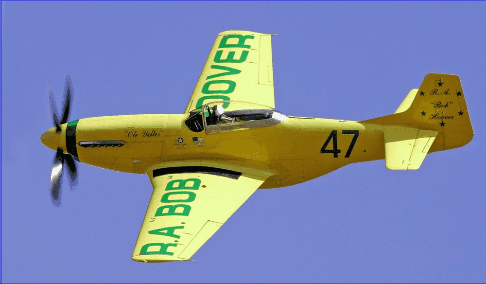

Bob Hoover is my hero. Saw his Shrike show in Homestead 1976.
Somewhere i have a photo of his yellow P51 upside down, gear and flaps extended, maybe fifty feet over the shrubs at end of Homestead General's runway 36.
He continued the roll and touched down perfectly.
I guess it just 'felt good' .
sorry for digression - 'old firehorse' instinct...
old jim

  • #168
