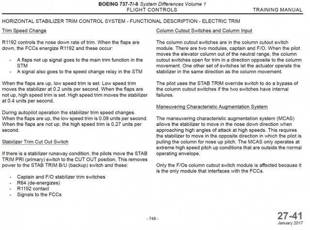

Actually that's exactly where I got it from. If you look at the image right above where you're quoting, which is a page from the flight manual, the last paragraph under the MCAS heading says:
"The MCAS only operates at extreme high speed pitch up conditions that are outside the normal operating envelope."
But as I've suggested, perhaps "conditions" is not saying it's only active with actual positive pitch attitude, but instead implying when the plane is being maneuvered to pitch the plane upward from it's current attitude. That is, it won't be active when the pilot is pushing forward on the yoke. Again the language is a bit confusing to me.

  • #290
It a page from the training manual:
In this case, "pitch up condition" means that the pilot is pulling on the yoke to pitch the plane further up. For example, he may be attempting to pull out of a dive.
A pitch up that is outside normal operating envelope is one that would either threaten a stall or threaten aerodynamic damage to the plane.
When the word "envelope" is used, it is talking about the flight limitations of the airplane - that are independent of its attitude.
That is probably why it it is also looking at the bank angle. Though that is not as well advertised, it is shown in the graphic as "steeply turning".
When a plane is making a turn at more than the standard turn rate, an "accelerated stall" is possible.
