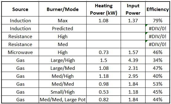

I've been doing some experimenting on this. I'm not finished, but here are some preliminary results:
I used a 2 gal pot with 1 gal of water for most tests, and a 5 gal for the "large pot" test. My range is an older/standard gas range and my induction cooker is a countertop one so it is lower wattage than an in-range one would be. I use propane and I think my range has been properly converted from gas to propane so the results should be equivalent for gas. Rates are measured from time and temperature change from near the beginning of heating up to about 150F or so. For the first few minutes condensation causes an increase in heating efficiency of 5-10%.
A few conclusions:
  • Gas heating efficiency does depend on both flame height and ring diameter. It's very clear that a mismatch in size (large burner dia, small pot dia) could cause most of the flame to miss the pot entirely.
  • For very small flames or large pots, loss from the pot to the air confounds the results.
  • A lid makes a big difference in reducing loss.
  • Stainless steel (low grade or cladded) vs aluminum makes no difference.
I'm going to do a test on resistance heating and also calculate energy costs for these at some point.

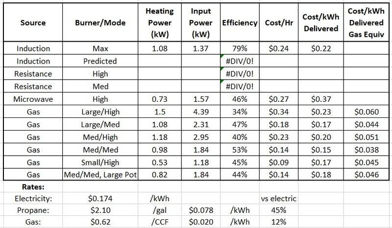

While his point is mainly regarding boiling time or, rather, power delivery rate, he mentions how shockingly bad the efficiency is of gas stoves at delivering heat (my numbers are better than his, probably because I'm using a bigger pot). This at best glosses over the efficiency issue and the near universally poor treatment of it in media and political discussions on this issue is the main reason I'm doing my tests. Point of use energy delivery efficiency is just the opening of a deep rabbit hole of the efficiency issue, which also encompasses cost and pollution. Now that I've regained my momentum, I've added cost to my results chart:
As you can see, cooking with an induction range costs roughly 4x(!) as much as cooking with natural gas. Note; I'm having some propane supplier issues so I'm paying close to double what I think I should for propane. I'll mostly set that aside here and focus on the natural gas vs electric.
The reason for the cost difference is mostly due to the low efficiency of electricity generation and delivery. 79% at the point of use is good, but if your electricity is created and delivered from natural gas at 30% efficiency, the total system efficiency is 24%, or a little more than half the efficiency of directly burning the natural gas for cooking. Electricity also has much higher delivery costs than natural gas, which is where the rest of the cost difference comes from.
The US power grid is a little more than half fossil fuel and depending on location it may be more coal or more natural gas....or more clean energy. Governments publish carbon emissions data for electricity on a regional basis. I'll add it to my spreadsheet later, but given that the full system efficiency is about half for electricity as natural gas and the grid is about half fossil fuel, it should work out to be roughly equal in carbon emissions, between electricity and natural gas. Electricity may be a little higher due to the other fuels being more carbon dense than natural gas.
Bottom line is that at current rates and production, cooking with electricity is many times more expensive than and just as dirty overall as natural gas. Obviously there are other benefits to induction though, including indoor air pollution and safety.
These issues also apply to discussions about electric water heaters and heat pumps for heating buildings. And also obviously as our grid gets cleaner the pollution issue will shift in favor of electricity, though the cost disparity for non-heat pump electric heating will likely keep getting worse. I'm dealing with this subject an increasing amount at work; I'm currently working on my first net zero carbon building project and writing a paper about it.

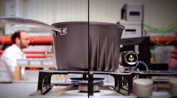

I have seen (in a restaurant supply place) cookware with very deeply finned bottoms. Like an inch deep fins. Purported to boil water much faster on a gas stove. I don't know if they really work. I looked just now for an image but I can't find it. I don't remember the "brand" name.
I'd never heard of that, but it should definitely help:
https://www.fastcompany.com/3033040/these-finned-pans-require-40-less-heat
The ones I saw had a thick (1 or 1.5 inch, say 32mm) aluminum plate bonded(?) to the bottom of the pan, with the fins cut into the plate. Next time I go into Resco, I will look for the maker/take a photo.
