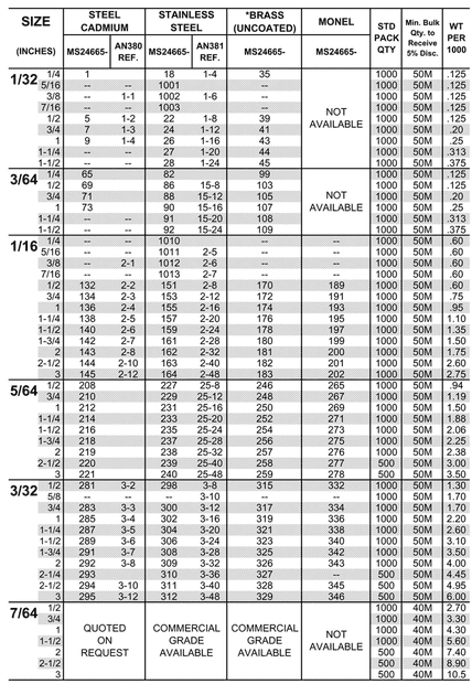

As another interesting aside, the stuff I'm most familiar with for pins is the MS24665 pins, which come in a huge variety of sizes.

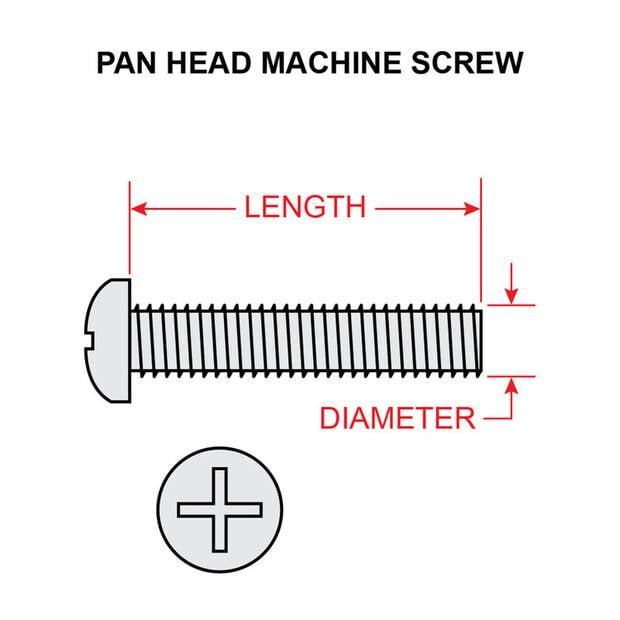

Counterpoint: Machine screws. They have well-defined standard parallel threads that can be tightened by turning a nut with the matching thread. They're very common. A good example that I remember is the AN515 or MS35206 family.

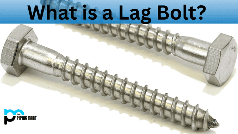

Further counterpoint: Lag bolts. They do not have an accompanying nut, but are called bolts.
That's why I went for the driving mechanism as the defining point.
