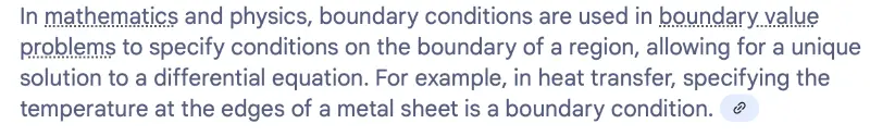

makamo66 said:
I want to get the boundary conditions for a board held at two edges by participants.
From the AI overview when I searched "boundary conditions"
So in your case, the boundary conditions would be "the two ends of the board are held." This could mean that the two ends are clamped and prevented from moving in any direction. If you want to allow the ends to move or consider participants' hands moving to some degree, then you need to describe what this means mathematically.
