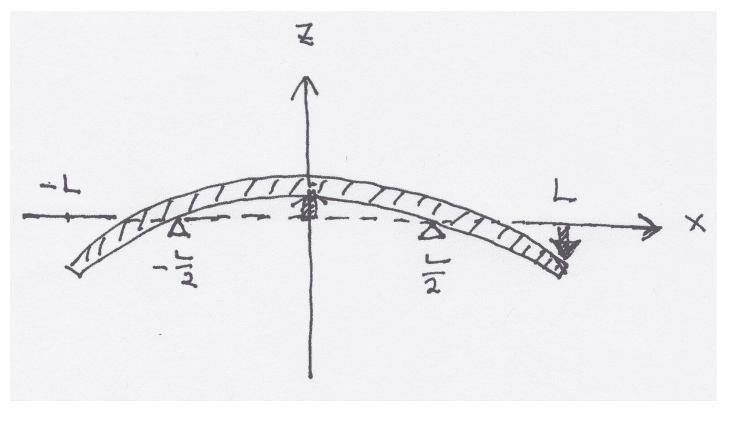

I'm trying to find the boundary conditions for the following problem:
A plate with length 2L is placed on supports at x = L/2 and x = - L/2. The plate is deforming elastically under its own weight (maximum displacement bowing up at x = 0). Both ends of the plate are free boundaries.
The goal is to eventually solve the equation DW'''' = q(x) for the right half of the plate (x > 0).
D is the flexural rigidity $$\frac{Eh^3}{12(1-\nu^2)}$$
E is Young's Modulus, ν is Poisson's ratio, h is the thickness of the plate, and q = -ρgh.
Since the right end of the plate is free, I think the two boundary conditions there are DW''' = 0 (shear force) at x = L and DW'' = 0 (bending moment) at x = L. What are the quantities I should be considering for the boundary conditions at x = 0? I feel like one of them is bending stress.
The bending moments and the displacements are zero at both ends. The reaction forces and shear forces are not.

By "ends" do you mean of the full plate (x = -L and x = L) or the half-space (x=0 and x = L)? I should also clarify that the ends of the plate (x = +/- L) sag beneath the x-axis.

Oh. I missed this when I was visualizing the system. Yes, the boundary conditions you proposed are the correct ones to use: zero shear force and zero bending moment at both ends.
