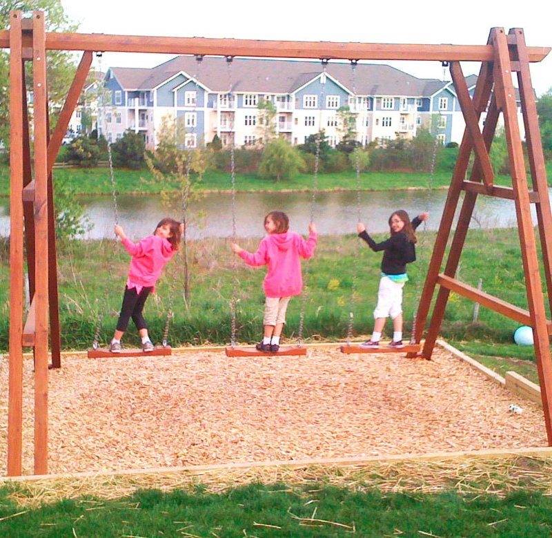

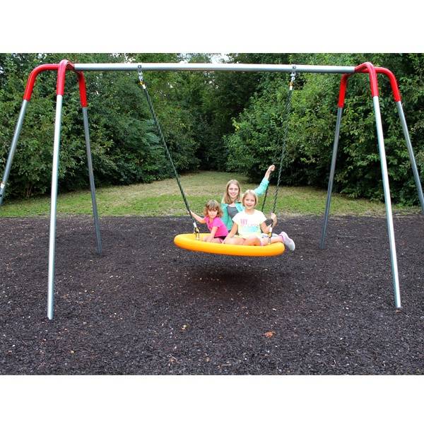

A structure similar to the ones for swings in playgrounds comes to mind, although a 2” steel pipe seems to be too weak for 15 feet horizontal and 200 lbf hanging midpoint.

Thanks so much for your reply!
I am open to using any kind of material that can fit the criteria I listed. Examples like aluminum ibeams (like a portable gantry crane), or aluminum truss, or schedule 80 3inch pipe gauge steel galvanized or titanium.
I like the second pic you got there and the fact that the load is distributed to two points instead of one in the middle; I'm assuming that helps decrease chances of overbearing the pipe?

The material selection also depends on the easier and more economic way to assemble the structure (bolts, welds, etc.).
The originally discussed 2-inch steel pipe will not permanently deform, but it will bend around 2.5 inches down at midpoint due to the weight of the bag alone.
Pipes are not good at resisting bending loads, I-beams and trusses are better.

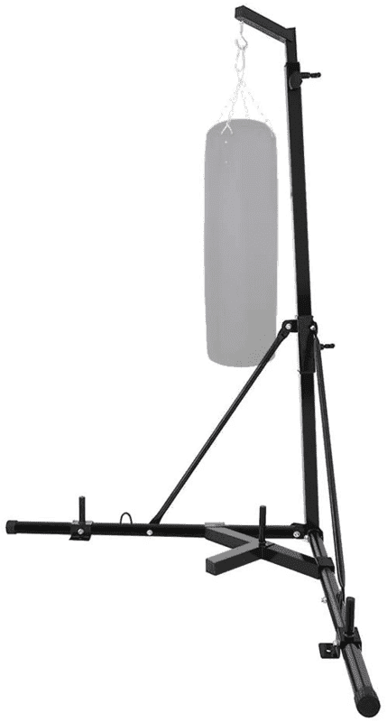

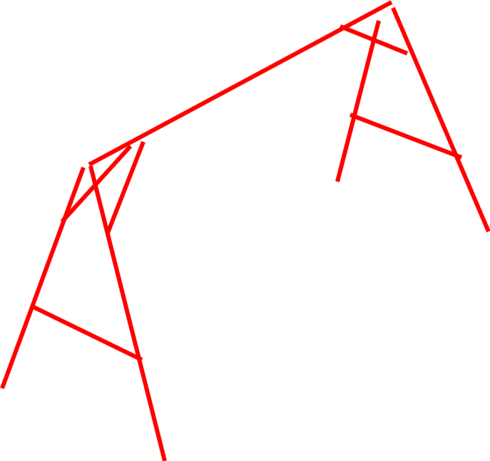

look at something like this for your design, all you need is some weights to keep it from toppling over when punching it
The bag didn't render quite right in the drawing, did it? It looks like it is behind the left diagonal support, but it's meant to be in front of it between the two outstretched floor members, right?
yes, that was an image from amazon.
