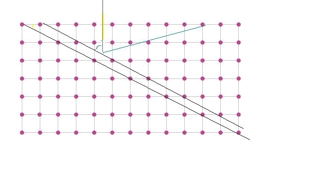

Suppose a square lattice. The planes are such as the image below:
I light wave incides perpendicular to the square lattice.
The first maximum occurs for bragg angle (angle with the plane (griding angle) as ##\theta_B = 30°## (blue/green), green/blue in the figure).
The angle that the interplanes of the crystal make with the horizontal is ##\alpha## (yellow).
What is the de Broglie wave?
To be honest, i am so confused with this question that i have no idea what to say.
The first immediate confusion is how an ray coming perpendicularly to the crystal makes an angle ##30°##, so that the complementar of it be ##60°##, if obviously the angle (yellow) makes is ##atan(d/2d) \neq 60°##

"Consider, as the figure below, electrons hitting the cristal surface at right angles, and suffering diffraction of first order in an Bragg Angle ##\theta_B = 30°##. Given that the atomic separation is ##D =2.15 A°##, and that the lattice is a square lattice, calculate..."
What botters me is that we need the figure to know the plane he is talking about, but the figure is wrong.
Since it was from a test, i will try to contact the professor. But i am afraid i am the only one that notice that (I mean, not because i am special, but because if you just look at the figure to know which plane you should consider (diagonal? horizontal? etc), and ignore the angles at the figure, you can solve it) (obviously i assumed that i was wrong at the moment and was afraid to ask to professor)
The figure is equal the one i posted here.

The professor answered me. Indeed it is wrong/ambiguous.
Unfortunatelly, he will not cancel it, but will consider two answers possible (one in which ##\alpha = 60°## (and so the angle bragg is ##30°##) and the other with ##\alpha = \arctan(1/2)##, which by itself changes the whole question, so that the electrons incides not perpendicular anymore). Since i was not able to concluded which of the two reasoning were right at the moment of the test, my answer is wrong anyway.
So, let's reformulate the question so that it be more general? Even so i am extremelly sad, i am also curious what is the answer for more general cases.
Let the planar angle with the horizontal be ##\alpha##, and the glancing angle corresponding to the maximum be ##\theta##. What is the corresponding wavelength?

Let’s use:
interatomic spacing = D
plane spacing (distance between adjacent planes) = d
Some questions:
Q1. Express d in terms of D and ##\alpha##
Q2. Knowing the Bragg angle (##\theta##) what is the standard formula relating ##\lambda, \theta##, n and d for the n-th order maximum?
Q3. Use your answers to Q1 and Q2 to give the formula for ##\lambda##.

Yes, indeed. That what exactly what i have written at the test, just before realized the inconsistence between the angles, erase it, and derive a nonsense formula (trying to considere both cases to be true (90³ and 60³), which is impossible and proves that i was not under my sanity anymore LMAO).
By the way, the question here was solved so. The topic can be closed. THank you :)
