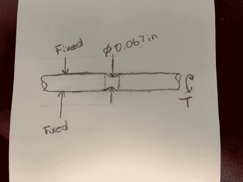

I am trying to design a drive shaft that breaks when i apply a specific torque to protect fro over torquing. I made a few samples, and now i am trying to compare the results to my equations. My problem is, none of the equations seem to match the actual results. Your help would be appreciated:
I made a bar that was 0.078in. in diameter, necked it down to 0.067in. diameter (.0335in. radius)
In testing, I found that the bar shears/breaks at around 9.6 in-lbs.
τ = T*r/J = 9.6in-lbs*.0335in/((π/2)*.0335in^4) = 164ksi
Now, my material states that I have an tensile strength of 170 ksi and yield strength of 140 ksi, and i thought, "Great! 3.5% error on my yield strength", but then i remembered the 0.577*σ rule. (making shear stress only .577*170 = 98ksi). I'd expect this to break at 5.7in-lbs using that conversion. Can any explain why my test results don't match up to my theoretical values?
(I considered using a stress concentration factor, but that would only make my answer more puzzling because it would increase the discrepancy where τ(max) = τ(nom)*K and K>1)Thank you

No, what I'm saying is that your material properties are based on a tensile test, not a shear test. To use those test results for calculating the max. allowable shear stress, the figure 0.4 sy is supposed to account for going from a tensile loading to a shear loading and any other unknown factors. The test figures on your material data sheets are the actual stress results from the tension test, but no one normally designs to the yield strength of the material.
For design in bending, where there are tensile and compressive stresses, you can design to 0.6 sy, where sy is the min. yield strength of the material. That extra 0.2 sy on the allowable stress is used as a cushion to guard against the vagaries of shear loading.
With your shaft, you want it to fail when a certain torque figure is encountered. Stressing a bar axially to yield doesn't necessarily produce failure; steel has a different figure called the rupture stress, which is the stress measured just before the test piece breaks.

What is the actual configuration of the shaft and surrounding parts - can you supply a drawing ?
For my test I put the fixed end in a drill press and the rotating end in a torque gauge and twisted the shaft (by hand, with the drill press off) until it came apart. I measure at almost 9.6 in-lbs every time i repeated the test. Obviously the drive shaft shears off at the necked down area. Wrapping my head around why the shaft withstood a higher shear than expected is why i am reaching out to you all.
Thank you for your help so far. I've been reading around in my old machine design books and doing other research, but haven;t come up with much yet. I appreciate the outside perspectives.

I'll give you a clue :
A simple beam does not fail when stress in outer fibres reaches yield stress . In fact you can usually load a beam a good bit more before actual failure occurs . Think about why this is and how you can apply similar thinking to torsional failure situations .

Are you suggesting that the failure is not happening out the outside radius? or possible there is some necking occurring which diminishes the radius? I think this is a possibility, however, to get a number that is relatively close to what I'd expect, the radius would need to change from 0.0335in to 0.0200 in. (which isn't impossible).
Is it possible that i am incurring some cold work into the material as well during my machining operation? it IS a 300 series steel I am working with.

As load is increased stress in outer fibres increases until it reaches yield stress .
What happens when load is increased further ?
Apart from the above issue, you state "Now, my material states that I have an tensile strength of 170 ksi and yield strength of 140 ksi". What is the reference that is giving you those values? I am asking this because most standard material specs for purchased materials are statements of minimum material properties and generally the actual properties of the purchased materials exceed those quoted minimum values.

As well as everything already mentioned there is the problem of ensuring that the shaft is subject to a pure torque . Any significant bending forces could change the value of the breaking torque considerably . Made worse in this particular situation because the shaft is so small in diameter and has a built in stress raiser .
There are really many problems in trying to get an exact figure for the breaking torque of this shaft . The best you will ever manage is to find upper and lower bounds for the value .

The only thing I can think in this case is that the torque that you are using might be slightly off or as the outer fibres of the shaft start to yield the fibres slightly deeper are forced to take more load until it partially yields as well and so forth until the shaft finally breaks. So when the shaft starts to yield more of it is at a higher stress and it ends up being able to take a higher torque. In normal shaft torsion theory you assume that the stress varies linearly with radius. After yielding starts this isn't true anymore though. The classical theory starts to break down at that point. I think this is more likely to be the cause of the error you are seeing. There is a name for it. Plasticity or something like that- I forget now...
Its the same mechanism that causes ductile metals to deal better with stress raisers than brittle materials. When there is a stress raiser in a ductile metal it yields partially, causing stresses to redistribute and ''average out''. I think the same thing is happening with the shaft. It ends with a higher percentage of the shaft being at higher stress and thus it's taking higher torque.
