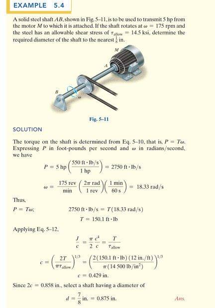

Hey guys,
I’m having some confusion with a certain section of the “Torsion” chapter in my mechanics of materials book: “power transmission”.
Please see the problem below. This is very easy to SOLVE (basically plug and chug with the equations), but conceptually, I am not understanding something:
I do not see how we are allowed to use the torsional formula to solve for the minimum shaft DIA when from what I see, there is no TORSIONAL stress. The problems that were explained earlier in the chapter made sense because they were FIXED at one end. So the support fights the rotation, and because of this, the polar moment of inertia due to the shaft geometry is fighting torsional deformation. Without the support, the way I see it currently, the polar moment of inertia isn’t really “fighting” anything…right?
Like, when I look at this: all I see stress-wise is a shear stress due to reaction forces from the “supports” (the motor attachment point and the bearing support) that prevent translation of the shaft, and the shear stress from the tension force of that belt (but it’s not given, so it’s assumed zero). I know it doesn’t say to solve for torsional stress, but we’re using the torsional stress formula to solve it.
Idk where I’m going wrong here, but I’m spending too much time thinking about this now….
Thanks for the response.
I’m not really seeing how that’s possible. The 5 HP is the power from the motor. The belt isn’t spinning the shaft.
And even so, like I said, I do see that there is a shear stress developed in the shaft due to the belt tension, but how is that torsional shear? The shaft is allowed to spin. There isn’t a resistance to the twisting
The nature of this problem is the same as of the problems that were explained earlier in the chapter that were fixed at one end (zero angular velocity ω): two moments are fighting each other; one is a dynamic situation (ω > 0) and the other one is a static one (ω = 0).
The motor induces a driving moment and the rotating thing at the other end of the belt loop induces a resisting moment while it rotates.
The size of the belt is selected based on the calculation of its tension while normally rotating; therefore, there is certain amount of tangential force, which induces certain amount of moment or torque on the shaft when combined with the radius of the belt middle line.
Same principle would apply if the transmision of power were done via roller chain or gears.
Hey, nice to hear from you again.
This does make a lot of sense. I guess because it’s moving I felt like it wasn’t fighting anything, but like you said: there is still a resistance from whatever is attached to that belt; regardless of if it’s moving or not. Not sure why I didn’t see that…..
So just be sure I’m correctly thinking about how these equations work: power (mechanical) is work per second…..or in other words, torque times angular velocity. So solving for torque, you get power divided by angular velocity. So as the weight of whatever is being pulled goes up, the angular velocity would drop (there would be less cycles per second) which would mean torque is proportionally increased. So basically, the power supplied from the motor is constant unless angular velocity or torque is zero. This seems odd to me for some reason.
The belt tension coming into the pulley is different from that coming out of the pulley. So there is a tension drop across the pulley. This tension drop times the pulley radius is equal to the torque the load applies to the pulley and the pulley, in turn, applies to the shaft.
