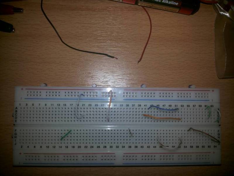

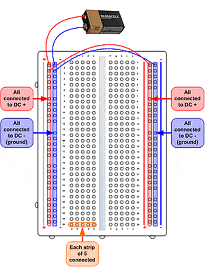

The discussion focuses on the proper grounding (GND) techniques for constructing circuits on a breadboard, specifically addressing the use of a round-hole breadboard model with 840 points. Participants emphasize the importance of understanding the internal connections of the breadboard, which features separated power bus strips. A recommendation is made to use a Digital Volt Meter (DVM) to verify connections and ensure proper grounding throughout the circuit. Additionally, a tutorial link is provided to aid in visualizing the breadboarding process.
