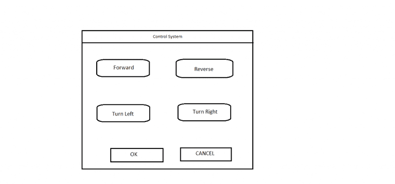

1. Basically, I want to take a piece of hardware and do system programming by using C and C++ computer languages and I want to develop User Interface using C# in .Net framework.
So, what I intend to do is I want to use Visual Studio Integrated Development Environment 2010 and develop user interface using C#.Net and ASP.Net and to make the hardware work I will write C and C++ code in the Visual Studio Integrated Development Environment 2010 where I developed User interface using C#.Net and ASP.Net to go with the hardware.
Is it possible to do things this way? I want to use C and C++ code in C# code in one program that I am developing in Visual Studio Integrated Development Environment 2010.

I have a build project. It is called "Radio Frequency Controlled Robot with Metal Detection and Image Transmission".
It has:
RF Transmitter STT-433 MHz
Encoder HT640
RF Receiver STR-433 MHz
Decoder HT648L
CMOS 8-bit Microcontroller Atmel AT89S52
It runs on batteries and remote controlled. I want to design a software or user interface that looks something like the following and must be able to run from Windows 7 or Windows 8. I want to write C,C++ code with C# code in Visual Studio IDE.
Do you have access to drivers and an Application Programming Interface (API) for the controllers?
No. I want to prepare drivers in C and C++.
Basically, I am planning to write C and C++ code for drivers and build user interface using C# in Visual studio IDE and use the drivers code in C# code in Visual studio IDE. I want to know if it is possible this way.
I somehow want to involve Visual Studio IDE, C# code and C and C++ code, altogether in one place just for the sake of knowing programming.
