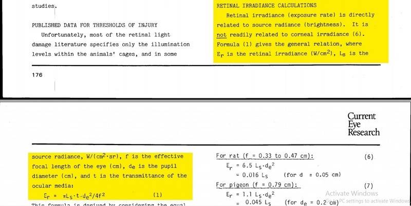

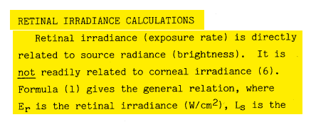

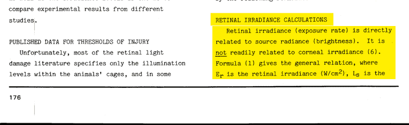

The goal of my search is to calculate retinal irradiance (W/cm^2) while measuring irradiance of the sun (which is in fact the corneal irradiance) during the course of the day. Unfortunately I didn't find direct correlation between both, here is quote from David Sliney, Ph D, Laser Institute of America, author of articles about retinal damage from extended and other light sources:
This is from his article "Quantifying retinal irradiance levels in light damage experiments "
Note the underlined in "It is not readily related to corneal irradiance", so knowing the solar irradiance is not enough. We have to know the solar Radiance, respectively the solid angle involved.
In general the question here is how is Ls (Radiance of a source), W/(m^2*sr) is calculated? Watts, and square meters are clear to me, but defining the solid angle seems to be a contradiction (even in this forum).
I don't see where you are going here. If you know the irradiance from the Sun then you know the power flux through the cornea. That power is distributed over an area of the retina which is the Sun's image. Isn't that what you want to know?
The sun's brightness over most of its disc does not vary much - just on the outer limb. See http://www.cv.nrao.edu/course/astr534/Brightness.html and many others. So the irradiance on (of?) the retina will be much the same over the whole image and equal to the power flux divided by the area of the image.
I don't understand how that attachment can say that the Source Radiance is affected by the focal length of the eye when the source is the Sun unless they are using some definition of their own. This hyper physics link defines Radiance in terms of Watts/m2 steradian, which makes good sense to me because it doesn't involve the receiving equipment at all. You seem to be assuming that those yellow bits of text are appropriate to what you want. (I appreciate that I am not yet considering the transmittance of the optical media - that's something to sort out later, I think). They are dealing with lasers which have narrow beams and so the beam may be smaller than the cornea - not your problem but could be very relevant to them.

I think I have found an answer to what I was looking for. I am not sure about the name of the first document, because I couldn't download it completely. It has something to do with optics geometry, optical design, optical sources etc.

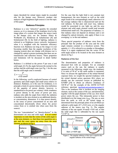

And another quote:
I L S C ® 2 0 1 3 C o n f e r e n c e P r o c e e d i n g s
The radiance of the sun, a 1 mW laser
pointer and a phosphor emitter
Karl Schulmeister

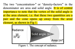

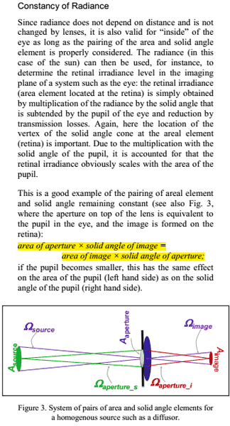

For me there are some important outlines here:
1. The vertex of the solid angle involved in calculating the radiance can be at either the surface of the source or detector;
2. The vertex of the solid angle must belong to the surface of interest, i.e. the vertex and the surface area form a pair, so if we decide to use the angle subtended by the detector with vertex at the sun as tech99 suggests we have to consider the irradiance of the projected area of the source(sun), at the source which of course is impractical;
3. Radiance remains constant through optical system with lenses (radiance conservation theorem);
4. The products of the projected areas by the corresponding solid angles are equal due to geometry. (See the yellow highlight above)
This makes it possible to calculate the irradiance at retinal image knowing the solid angle subtended by the pupil.
5. From p.3 and p.4 we derive that Power also remains constant in optical system with lenses (of course if transmittance is equal to 1) Power1/Area1*solid angle1 = Power2/Area2*solid angle 2, since the products of areas and solid angles are equal, then power must be also equal.

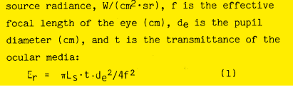

The radiance of the source, together with the focal length of the eye (which defines the solid angle) both define the retinal Irradiance as you can see from the formula:
Er=pi*Ls*t*de^2/4f^2
Source Radiance is independent of focal length, not sure how you came up with this conclusion.
Basically what this formula does is multiplying the Radiance of the source by the solid angle subtended by the pupil with vertex at the retina ( and of course transmittance is taken into account ). Of course this works fine for small angles as area of the pupil is used for calculating the solid angle.
Both ways - with this formula, and with corneal irradiance yield the same results, I have checked it. The reason for deriving this formula, as explained in "Safety with lasers and other optical sources" is the necessity to have easy to use formula for every source with known Radiance without the concern of viewing angle, viewing distance (i.e. size of retinal image doesn't need to be calculated) and also corneal irradiance measurement is not needed.

Which do you want, radiance or irradiance? That attachment talks about radiance being dependent on focal length. It may jut be a typo but it cannot be right.
The goal is Retinal irradiance, W/cm^2 because you can then calculate the energy dose J/cm^2 for given duration. In the literature all threshold values for retinal lesions are in J/cm^2. However I started this thread because I couldn't understand how Radiance of the source is calculated when Irradiance at a surface is known.
Yes you're right Ls, source radiance is independent from focal length, it doesn't make sense. Maybe you got confused because I have mixed a little bit the attachments, as the text is spread across two consecutive pages. But to be honest I didn't find text segment about radiance of the source depending on focal length. I will attach it again.

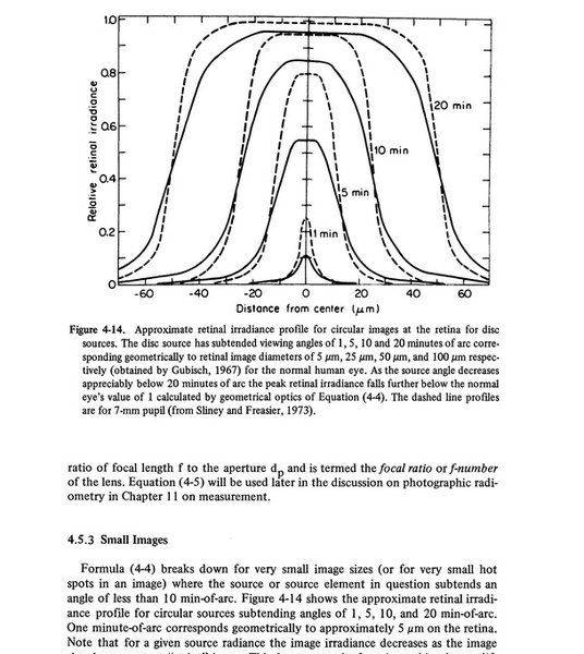

I think that it would be reasonable, given the irradiance, the aperture and the distances involved, to infer the radiance of the Sun but isn't the important factor of the area of the Sun's disc needed too, when you are dealing not only with irradiance but total power dissipation on areas of the retina?
This indeed was something to think about, but I think that the damage will appear in the area of highest irradiance. The blurred image around should have lower irradiance, and thus if we calculate safe levels for the focused image (159um for the sun), the dissipated rays shouldn't be a problem.
Absolutely- but the level of irradiance in the areas immediately surrounding the peak is likely to have an effect. You get similar effects with film and CCD camera sensors, where there is a region around the peak which is affected. It would be reasonable to suspect and a sensor that's subjected to an isolated peak of irradiance could be affected less than a sensor that's in amongst a number of others. Over a longer period, the temperature would be higher (way past the point you're interested in, I would think) but what about charges and chemicals, produced by the overexposure? The effect of the actual image size on a sensor will affect the image so I would expect the retina would react in a similar way. The Sun image is always more or less the same size, of course, when in focus.
I will attach a graph representing the relative irradiance on the retina. 1,0 represents 100% of the irradiance calculated by the formula Er=pi*Ls*t*de^2/4f^2. The image of the sun on the retina is 159um, so there will be maximum irradiance at the image. The author notes that the formula breaks down for images smaller than 10 min of arc, or 50um . As you can see the irradiance decreases as we go further from the centre of the image. The important part of the image is where the maximum irradiance is, and the damage will(should?) appear at this area if the threshold values are exceeded. It doesn't make sense to me that the damage will appear at other areas with lower irradiance. (the image is from free preview of book available on google books)
