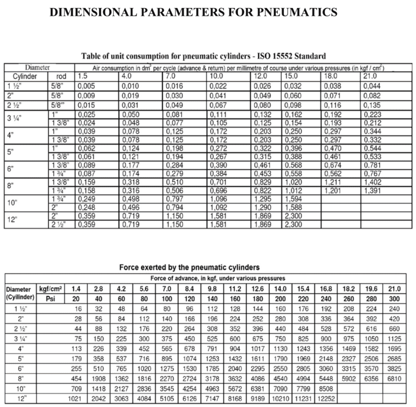

kgf/cm^2 = 50/(3^2) = 5.6 rounded up.
I calculated the value of kgf/cm^2 from given values. In the second table (Force exerted by the pneumatic cylinders) I see my value 5.6 exactly but how do I then read the table to get the diameter of the cylinder and then the rod?
I then am stuck on how to calculate the total consumption, displacement and speed of cylinders, pipes and hoses as I didn't learn this in class.
Can anyone help explain this for me?
Below are images of the table standards:
Two tables titled Dimensional Parameters for Pneumatics: a unit air consumption table for ISO 15552 cylinders by diameter, rod size and pressure in kgf/cm², and a table of force of advance in kgf under various pressures.

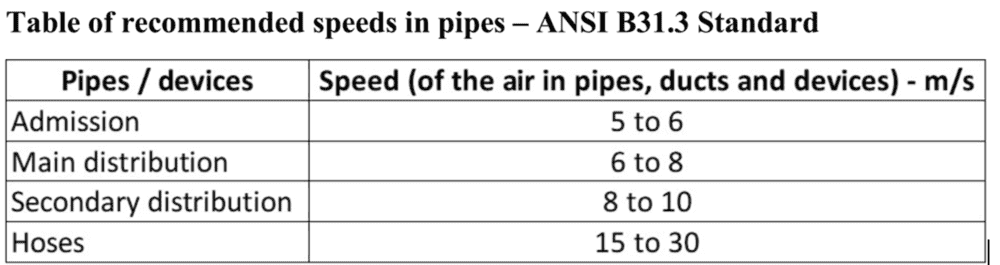

Table of recommended air speeds in pipes under ANSI B31.3: admission 5 to 6 m/s, main distribution 6 to 8 m/s, secondary distribution 8 to 10 m/s, hoses 15 to 30 m/s.
I think I've worked out that my total consumption is 4 dm3. Is this right? By:
50/(3^2)= 5.555555...6= 5.6 rounded up. For kgf/cm^2
Using force exerted by the pneumatic cylinders table...
Pressure will then be 80 psi.
Pressure/Force= 80/5.6= 14.28571429= 14.3 rounded up. (To get the area of the cylinder!)
The closest force exerted is 64 kgf.
So the diameter of the cylinder will be 1 1/2".
Then using the ISO Standard table...
So the diameter of the rod will be 5/8".
So then I will take 3cm and cube it to make 9 cm^3. I will then transfer that to dm^3 which will be 0.009 dm^3. Closest value is 0.010, which equals to 4 dm^3 of air consumption.
I still don't know about displacement or speed! So if anyone could help explain these that would be great!
