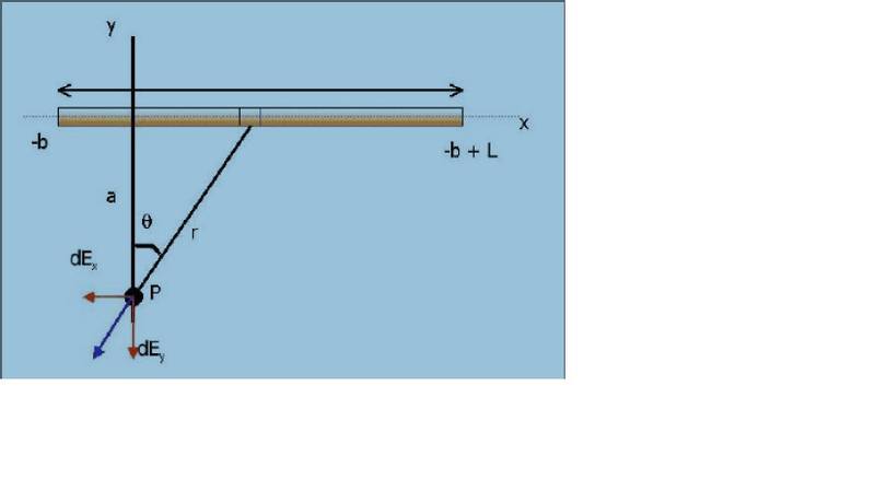

A rod of length L has a uniform positive charge per unit length λ and a
total charge Q as shown in figure below. Calculate the electric field at point P.
http://www.flickr.com/photos/68849979@N03/6261311950/in/photostream"
Been stuck at this question for some time. Could someone point me in the direction as to how should i tackle this question? Great Thanks!
I know I have to solve for both the vertical and horizontal component of E-field. Bu where do i go from there?

You need an expression, dEx for the x-component of the electric field at point (0, -a) due to an element of charge dq at location (x,0) on the x-axis.
You also need an expression for dEy, the y-component at the same location, due to the same element of charge as above.
To find the electric field, E, integrate each of these components from x = -b, to x = -b+L .
Managed to find the x-component but I'm having problems with that in the y direction.
I'm taking dE in the y-direction= k dq/ sqrt(x^2+a^2) X a/sqrt(x^2+a^2)
But the answer that i get after integrating it is different from the answer given. Where have i made the mistake?
dEy should be the negative of that.
What do you get for a result?
What is the given answer?
Added in Edit:
In dEy: That first sqrt factor should be squared.

dE in the y-direction= k dq/ (x^2+a^2) X a/sqrt(x^2+a^2)
my bad. it should have been this. A typing error. where could the mistake have been made? i got some weird answer after integrating this.
