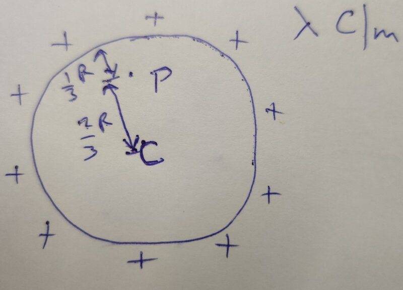

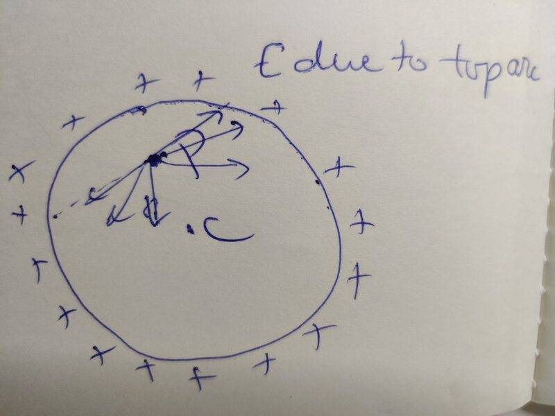

A charged circular non-conducting ring of radius ##R## has a charge density of ##\lambda## C/m. Would the electric field at point P as shown in diagram be zero? Explain the reason for your answer.
##E=\dfrac {kq} {r^2}## where E is electric field magnitude due to a point charge q at a point that is distant r from the charge q

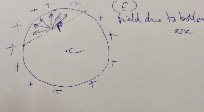

I have broken the ring into a top arc and a bottom arc.
First, let's assume an imaginary charge of +1 C is placed at point P. We will determine the force on this unit charge from top and bottom arcs.
The charges in the top arc will result in electric fields that will all cancel each other perpendicular to line CP leaving us with a net electric field pointing radially inward along the line CP. This is shown in diagram.
Similarly, the charges in bottom arc will result electric field vectors that will cancel each other perpendicular to line CP leaving us with a net electric field pointing radially outward along the line CP. This is shown in diagram.
After above analysis, I am confused since it's difficult to reason whether radial outward electric field at point P will be greater than or less than or equal to the radially inward electric field at the same point.

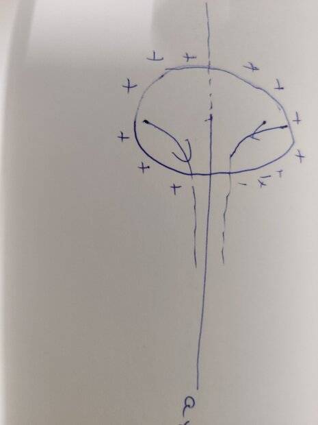

As for if the field would be radially inwards or outwards, it will be radially inwards if the ring is positively charged. To see why imagine how the electric field would look like very near the circumference of the ring and from the inside and outside of the ring.
Also, one could say that the field should be radially inward at P because electric lines of force for a +ve charge must emanate from it rather than end at it. So electric lines of force must be coming out of the +ve charges on ring as we go outwards or inwards from the ring. Does this make sense?
Yes this is my basic line of thinking too, coupled with the fact that the direction can not change somewhere in between along the radius from the center to the circumference because that would mean that ##\nabla\cdot\mathbf{E}\neq 0##, but we know from Gauss's law in differential form that ##\nabla\cdot\mathbf{E}=0## for all points inside and outside the ring.

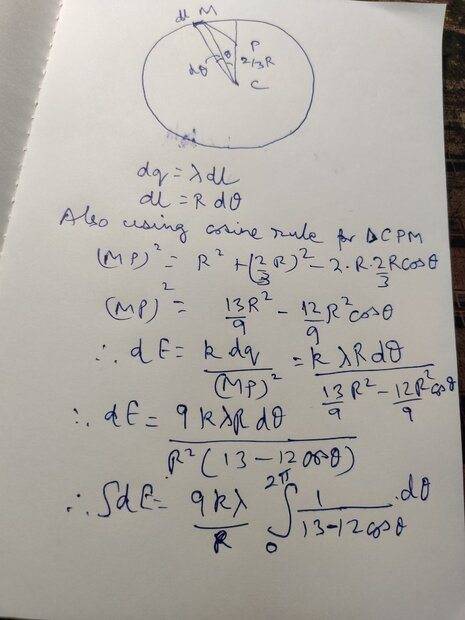

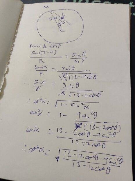

Following the recommendation of applying Coulomb's law at point P, I came up with following analysis.
Consider an infinitesimal element ##dl## as shown in diagram below and determine the field ##dE## due to this element at P. We then integrate from ##\theta = 0## to ##\theta = 2 \pi## to get the net E at point P due to the charges on the ring.
The dE you calculate above is the magnitude of the electric field from the element ##Rd\theta##. But you need only its radial component (that is the component along the line CP). You need to multiply it by the cosine of an angle. You can find the sine of that angle by the sine law on the triangle CMP and then use ##\cos^2x+\sin^2x=1## to find the cosine.
P.S ##\sin x## will be a function of ##\sin\theta##.
Oh, I missed that. I will look at it and rework my solution. Thankyou.

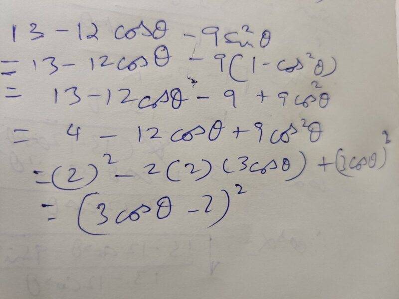

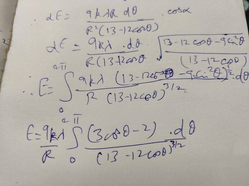

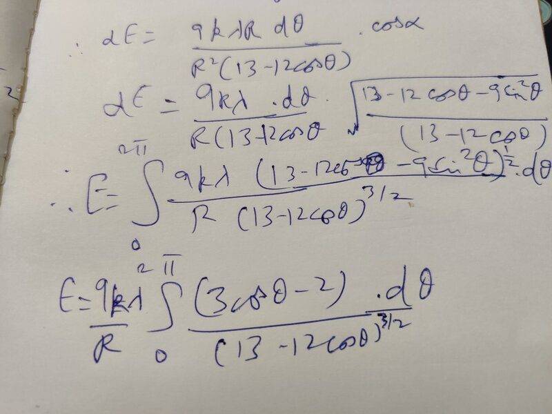

I get the following that results in a complex integral.

Delta2 said:
It seems correct to me what you do there except the very last step where you simplify the numerator to ##3\cos\theta-2##, what trigonometry identities you used there?
I simplified the expression as below.
Ok I see, then ##3\cos\theta-2## should be inside absolute values inside integral that is ##|3\cos\theta-2|##, cause ##\sqrt {X^2}=|X|##.
Is this integral doable without using approximations and numerical analysis?

Actually, after a lot of thinking the answer is that electric field at P is not zero but pointing radially inwards. Let's consider a case where point P coincides with point C. Then the top arc is a semi-circle and so is the bottom arc. We know from symmetry that all upward components of E at C due to lower semi-circle would cancel with all downward components due to top semi-circle. So electric field at P is zero if P coincides with C.
Now let's move point P upwards from C, then the top arc decreases in its length and the bottom arc increases in its length. This means all downward components of E due to upper arc (smaller than a semi-circle) would be less than the sum of upward components due to lower arc ( bigger than a semi-circle).
Of course, horizontal components would always cancel due to symmetry in all cases of P.
From above argument we can conclude that electric field at P is not zero but pointing radially inward.
