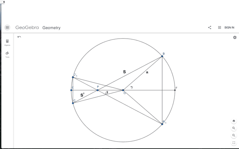

The element from the right side is proportional to ##\Large \frac {R^2 sin(\gamma) d\gamma}{s^2}## and from the left side ##\Large \frac {R^2 sin(\beta) d\beta}{s'^2}## but in opposite directions along the axis. I know that ## sin(\beta) = {\Large \frac{s'}{s }}sin(\gamma)## and I believe ## d\beta = {\Large \frac{s'}{s }}d\gamma## making the two differential elements cancel at all angles. But I am having difficulty proving the relationship between ##d\beta## and ##d\gamma##. It is easy to see when the angles are very small and when ##s## and ##s'## are vertical but not easy to see in between. I did precision numerical calculations however to verify that the relation ## d\beta = {\Large \frac{s'}{s }}d\gamma## holds for wiggles around any angle. All that just makes ## \large \frac {R^2 sin(\beta) d\beta}{s'^2} → \large \frac {R^2 sin(\gamma) d\gamma}{s^2}## so the elements cancel.

Call angle BPO ##\alpha##.
Angle PBO= Angle PCO=##\gamma-\alpha##.
##s\delta\alpha=R\delta\gamma\cos(\gamma-\alpha)##
##s'\delta\alpha=R\delta\beta\cos(\gamma-\alpha)##.

Considering the question of the charged ring in the OP, the paired differential elements are proportional to ##\Large \frac{R d\gamma}{s^2}## and ##\Large \frac{R d\beta}{s'^2}## and making use of ## d\beta = {\Large \frac{s'}{s }}d\gamma## gives ##\Large \frac{R d\gamma}{s^2}## and ##\Large \frac{R d\gamma}{ss'}## which do not cancel because ##s^2## is always larger than ##ss'## until the very end when they become equal as both become vertical in the plot. This is also where the integration ends. Also note even though ##s## and ##s'## depend on ##\gamma## and ##\beta## respectively, the product of ##ss'## is a constant ##ss' = (R+r)(R-r)## where ##r## is the distance point ##P## is from the center along the central axis of the circle. I ignored the cosine factors which make the integration messy because it is the same for both paired elements and the whole point of this approach is to answer the original question if the electric field is zero or not while avoiding doing the integration.

Thanks. I finally understand your derivation for ##d\beta\ = \Large\frac{s'}{s} \large d\gamma##. The difference between ##B## and ##B'## and ##C## and ##C'## is greatly exaggerated.
