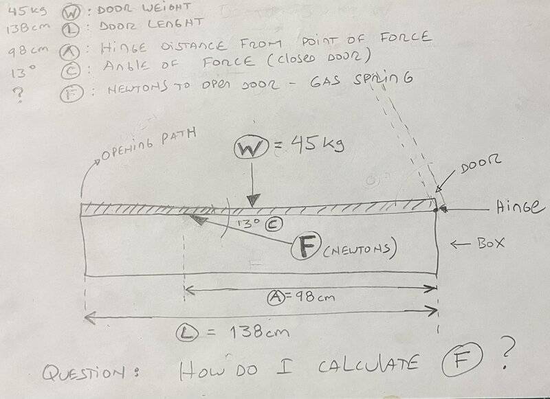

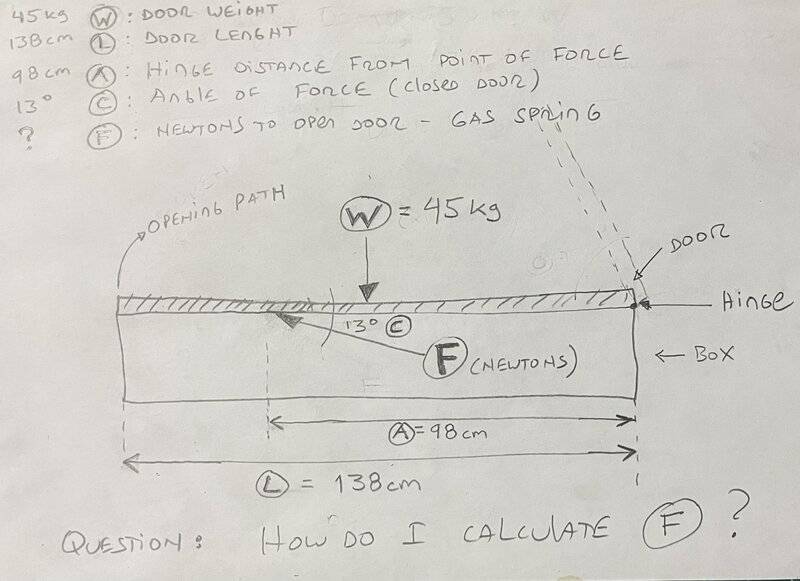

How much force (F) in Newtons needed to open a 138 cm long (L) 50 kg door (W) at a contact point 98 cm. (A) away from the hinge ata 13 degree (C) angle?
I need the ecuation to calculate F
Handwritten free-body diagram of a box with a hinged door on top. Labels: W = 45 kg at door centre, L = 138 cm door length, A = 98 cm hinge distance from point of force, 13° angle of force (closed door), F gas spring force in newtons, with a hinge and opening path shown.

If the diagram is looking down from above the door then the force needed depends on friction. If there is no friction, even the tiniest force will open the door, it just might take a while.
If it’s a horizontal view, the door opening upwards, then the weight of the door matters, but it will be 45g, i.e. ##45kg*9.8m/s^2=440N##.
First, figure out what condition is necessary to open the door then compute what value of force F meets that condition. A hint is to think about moments.

I think my consultation needs extra information. The door is in horizontal position. The question is aimed at finding the force, in Newtons, for a custom made gas spring arm, like those used in SUV's and hatchback cars so that it is easier to lift the trapdoor. The F vector stands for the force that will be excerted by the gas-spring, at an angle of 13 degrees in order to achieve Static Equilibrium. The force (F) needs to compensate the weight of the door at the pivot point so that the sum of forces is cero and the door can be opened with little effort. The weight of the door at the pivot point of the arm is aprox 33 kilograms, (the point of excertion is not on the end, otherwise it will be 25 kg) and if I divide 33kg by sine of the angle, sin(13)= 0.224951, and then multiply it by 9.8 (gravity pull), the result for F will be aprox 1466 Newtons, which is the force needed for there to be Static Equilibrium when the door is in closed position. I'm asking this question because even though I have done some research, I want to be sure the answer is close to 1466 Newtons because if I order the gas-spring with too many Newtons the door will not close, and too little Newtons the door will be too heavy to open. I just need someone to confirm if my calculations are correct or if I need to correct something. Thanks!

Ok so this is not really a homework problem for a class. The 13 degrees is the angle the gas spring is constrained to operate at during the initial opening. Your math seems correct but it seems to me that you can speak to the company you plan to order it from and they may be able to confirm the size and operating characteristics of the gas spring you need.

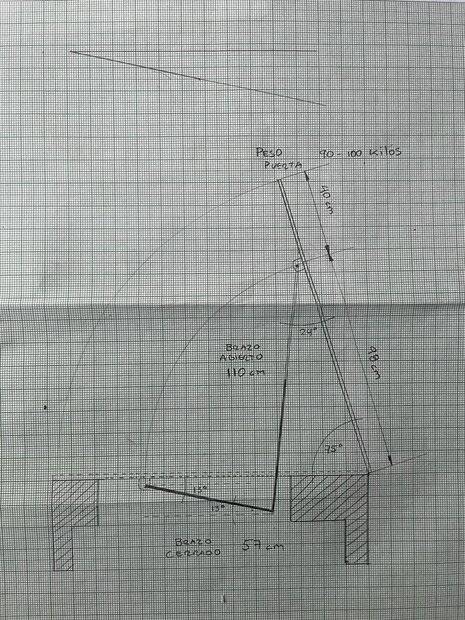

I am just curious but could you show a simple sketch showing the restrictions? Also, what safety margin are designing into the system?

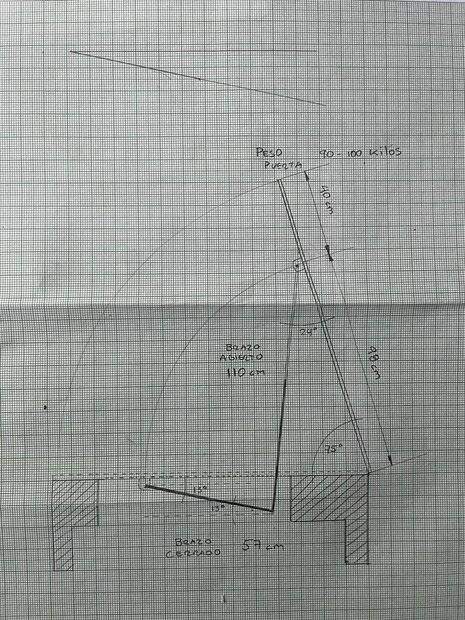

Hi, this is the sketch I made to make my calculations. I am going to order the arms with a little less force so that the door stays closed when left alone since there is no latching system. If I go over in force than it won't stay closed in equilibrium and I'd would rather have to exert a little bit more force when opening. I guess that is the "safety margin" you are wondering about.
  • Handwritten sketch of a box with a hinged top door: W = 45 kg weight at the door's centre, L = 138 cm door length, A = 98 cm hinge distance from the point of force, 13 degree angle of force, F in newtons from a gas spring, and the question 'How do I calculate F?'
  • Hand-drawn mechanical sketch on grid paper of a hinged door with a gas spring arm, showing a 110 cm arm, a 57 cm cylinder arm, a 40 cm door arm, 48 cm, 24 cm, and angles of 75 and 13 degrees, with 'Peso 70-100 kilos' labelled at the door's end.

I cannot understand your new diagram. The arm (black line) seems to be L shaped, but the two ends of the unequal arms would be adjacent when the door is closed, which is not possible.
Where is the arm hinged at the floor end?
If it is not a straight line, what shape is it and where on it is the spring?

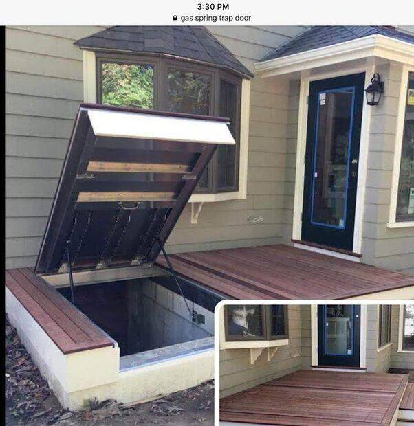

This is one kind of design;
Photo of an exterior cellar hatch set into a wooden deck beside a house, the hatch raised open on two gas springs to show the dark opening below and the hatch's underside with its support bracket.

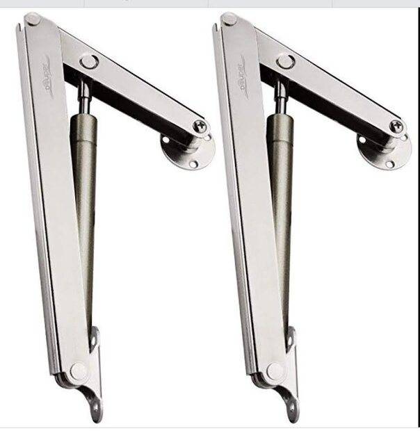

Or perhaps the gas springs you will buy look like this?;
Two identical stainless steel lid-support hinge mechanisms, each with a linkage arm pivoting on a wall-mount plate and a gas spring cylinder between the arms.

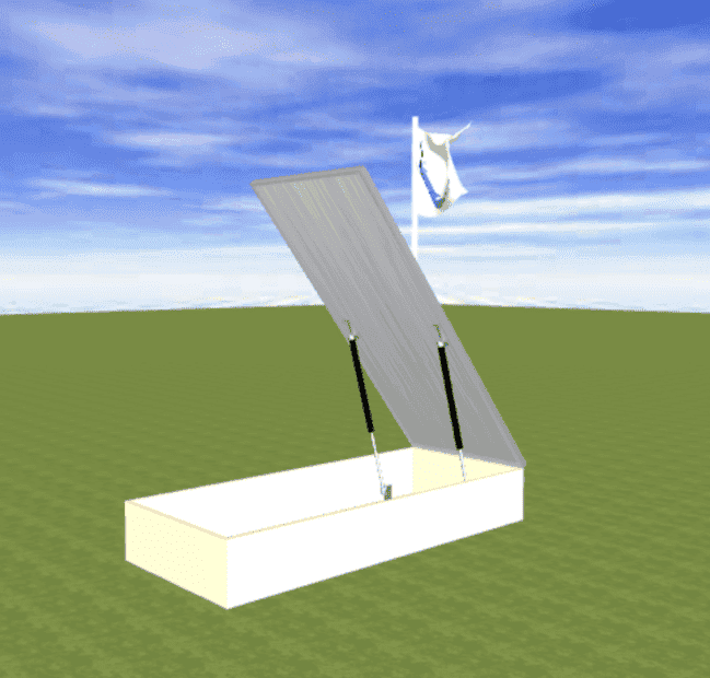

It looks L shaped because you are actually seeing both arm positions depicted simultaneously in the same drawing. The upright line represents the arm in open door position (110cm.) and the more slanted line represents the arm in closed door position. The data for closed position is the one I make my calculations with in order to find the static equilibrium. The arm will be hinged at the floor end against the lateral wall of the entrance (similar to your photo) but the arm door pivot will be farther from the hinge than the wall pivot, as in the new image:
  • 3D render of a box-shaped hatch with a tilted grey panel propped open by two black gas springs, with a white flag on a pole behind it on green grass under a blue sky.

So the equation you need is the torque balance in the closed position.
The torque from the weight of the door is its weight (mg) multiplied by the distance of its mass centre from the hinge (138cm/2).
The torque from the spring is the force it exerts multiplied by the perpendicular distance between its line of action and the hinge (98cm sin(13°)).
There is also the question of what happens as the door opens. Both torques and the spring force will change. There could be a risk that the spring will exert too much torque, producing a hazard as the door opens too fast, or making it difficult to reclose. But I imagine the gas pressure will drop too much for that to be a worry.

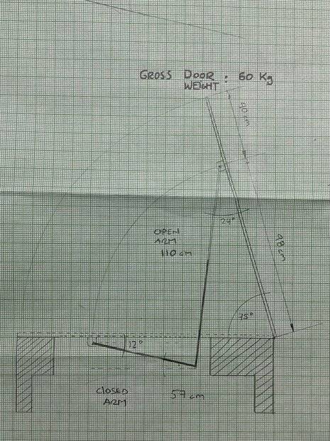

I appreciate your help a lot. At the floor end the arm will be attached to a lateral wall.
I just revised my design and made sure all the input data is right. Please disregard previous diagrams, enclosed you will find the final design with some adjustments.
Regarding the pivot position of the arm against the wall, the horizontal distance from the door hinge is 42 cm and the vertical distance from the closed door is 15 cm. The arm will be connected to the door at a distance of 98 cm from door hinge and at a vertical distance from the door of 3 cm. Tis diagram is made on a scale of 1:10 on milimmiter paper.The angle is actually twelve (12) degrees. The gross door weight is 60 kg. That will mean 30 kg if lifting perpendicularly from the edge (138 cm from hinge). Since the force excerted by the arm is not going to be from the edge but 98 cm. from the hinge, my calculations result in aprox 39 kg. at that point. Now, what I think I should do is take the 39 Kg, divide it by sin(12) and multiply by 9.8. The result is 1838 Newtons. Since it there are going to be two (2) arms, and I want to be on the safeside (the door staying closed even if these means a little bit heavier to pull up) I am planning on ordering the arms with 850 Newtons each.
Note: The arm dimensions (57cm closed and 110 cm. open) are a fixed variable which I can't change. The arm fixing points positions are the best I could come up with regarding the fixed arm dimensions but making sure the door opened at least 75 degrees. I can play around with the fixing positions as long as they are not in the area with diagonal lines (concrete) and as long as the two pivot points are 57 cm apart and at least at a 12 degree angle (a smaller angle will mean too much force required).
Basically all variables are kind of fixed except the Newtons for the arms which is what the manufacturer asks me. It's a small shop down here in my country and they won't do calculations for me.
I don't have the force curve for the arms but I guess as long as the arms have up to 10% less force than the one required for static equilibrium I should be ok. I am even be considering the arms ordering with 20% less force (1500 Newtons for both arms) to be on the safe side. The door won't have a latch or locking system and this is not a possibility because of design requirements.
I just want to be somewhat sure that I am al least close to "ballpark" I don't either want the door to not close when left alone or to be too heavy for lifting!
  • Hand-drawn scale diagram on grid paper of a door hinged at the right, labelled gross door weight 60 kg, with open arm 110 cm, closed arm 57 cm, a 98 cm dimension to the door, and angles of 12, 24 and 75 degrees.
So that's 60x138x9.8/(2x98sin(12))? I get 1991N, but that's a minor matter.
The only other thing I would check concerns my guess about how the force exerted changes as the arms extend. If it falls off a lot, fine; otherwise might need to ensure the torque is not excessive in the open position.

1991N is correct, I was a bit sloppy with the rule of thirds calculating the mass of the door at 98cm.
I'll check with the manufacturer what the fall off is to be on the safe side.
Problem solved, thanks so much!
