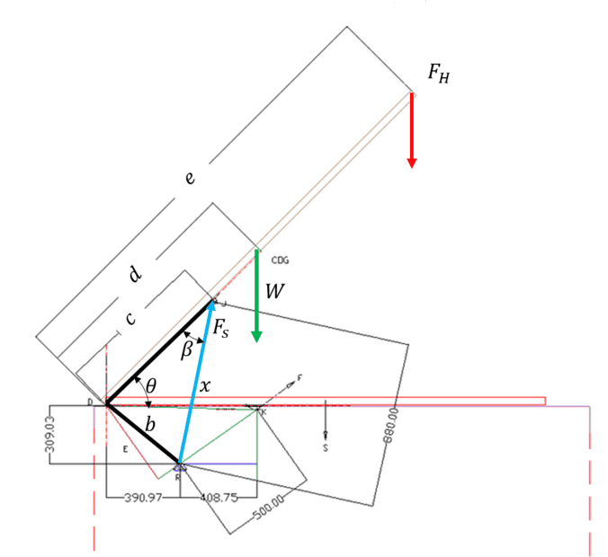

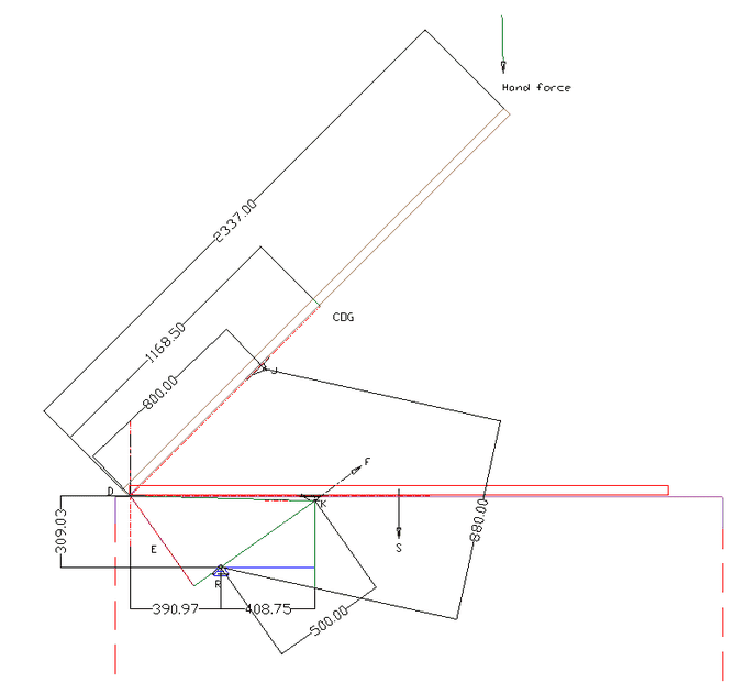

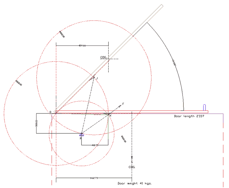

I am trying to calculate the hand pressure required to close a Hatch door which is held in the open position by 2 gas springs. I have done all the trig and geometry and force calculations except for the Hand Pressure, there I am confused.
Please show your calculations. Also I don't see the force applied by the springs.
Hi Russ,
Thanks for the response. The formula I have to balance forces is F*E = S*J from which I get F = (S*J)/E
weight of door 41 kg 410N COG is 0.804 (M) Moment arm E is 0.448 (M)
F = (410 * 0.804)/0.448 735.8 (N) total 367.9 per spring extended spring.
F = (410 * 1.163)/0.477 999.6 (N) 499.8 compressed spring

Maybe you could just get rid of the circles and replace with dimensions with increase font size all over?
The gas springs ( if they are truly gas springs), are going to apply a variable force, because 1) the gas acts as a non-linear spring and 2) the geometry of the applied force is changing as the door closes. Are they really gas springs or are they gas dampers?
The force is going to vary as a function of the angle. Also how the force is applied; is it always normal to the door, or more likely does it start out vertical and become more "normal" as the door approaches the closed position?

I will update my sketch. Yes they are Gas Springs. I need to calculate hand force required to open and to close the hatch door.

Ok. And think about how the hand is applying the force (in which direction). I think the hand will more or less apply a force vertically throughout the range of motion.
Can you balance torques about the hinge using these variables I have labeled?
Please see LaTeX Guide for learning how to post mathematics on the site.
Thanks Erobz,
I think it is something like Torque=2Fs*(Moment)+Fh*e - 0.5(e cos theta)W=0
but I cannot get it to balance.

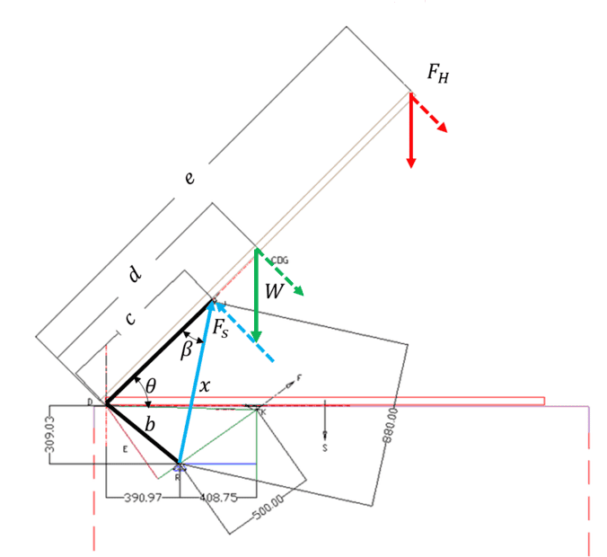

You should resolve all forces into components perpendicular to plate to examine the sum of torques, not just the weight of the door.

"perpendicular to door" I should have said. The torque looks at components of forces perpendicular to the moment arm of each force. You did it correctly with the weight, but did not do it for the other forces acting on the door.
Just in case you have gotten stuck; The dashed components of the forces are what contribute to the torque.

I think I should have written 2 ((c cos β) Fs) + (e cos θ) FH – 0.5 (e cos θ)W = 0
Geordielad said:
Thanks,
Not quite...but close. Check which trig function defines the desired spring force component, and check your signs. You've defined a counterclockwise torque as positive (I think...). Are your torques consistent with that convention?

Thanks I think this is what you are asking for 0.5 (e cos θ)W + (e cos θ) FH – 2 C(cos β) Fs = 0

I used 0.5W because I was taking the weight force from the COG. which would be half of e. Am I missing something?
Apologies I do not know how to load Latex and MathJax.
No, I flopped the variables on accident. My bad, I edited the equation.
What you are missing is that the component of the spring forces perpendicular to the door is ##2F_s \sin \beta##

Hold on, that is just the tip of the iceberg. We haven't even really begun to untangle this. There are a few significant challenges ahead if you are looking to find the force ##F_H## as a function of ##x##?
Even if you are satisfied to do it numerically using a scale drawing to find all the angles at dozen or so points, we still have to talk about the spring force.

Correct equation.

A next step may be to just solve it for ##F_H##.

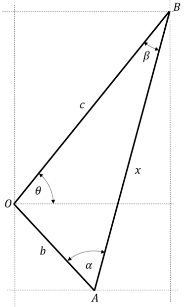

After that, finding ## \sin \beta ## as a function of ##x## is pretty straight forward using the Law of Cosines. It's when you get to finding ##\cos \theta ## as a function of ##x## it gets a bit involved... Finally, we would find the spring force as a function of ##x##.
Just waiting on you to tell me when you get stuck, and show me what you've figured out. Here is a diagram to get you started on the trig.
Okay solving for F_H
$$0.5 (e cos \theta) W + (e cos \theta) F_H - 2(c sin\beta) F_s=0 $$
$$0.5 (e cos \theta) W + (e cos \theta) F_H = 2(c sin\beta) F_s $$
$$ (e cos \theta) [ 0.5 W + F_H ] = 2(c sin \ beta) F_S $$
$$ [ 0.5 W + F_H ] = 2(c sin \ beta) F_S / (e cos \theta) $$
$$ F_H = (2(c sin \ beta) F_S /(e cos \theta)) - 0.5 W $$
