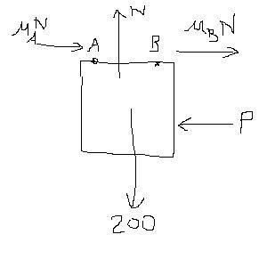

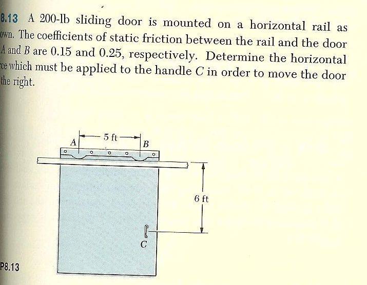

We have a 200-LB door hanging from 2 rollers, A & B, which are 5 feet apart. Coeffs of friction for A and B are .15 and .25, respectively. A force P is applied to the door. How big must it be to move the door to the left?[/B]
I have included a FBD. The downward force is the 200LBs, so the normal force would be 200, or 100 at each roller. That's reasonable, since the whole thing is symmetrical. The forces in x direction are P (to the left) and the total of muAN and muBN to the right.
So here we go:
Sum of forces in x: -P + (.15)(100) + (.25)(100) = 0
This yields a value of 40 for P. The book's answer is 45.5
Hmmm...been struggling with this for a week. Not sure where I made a wrong turn. Any help appreciated. Thank you.:biggrin:
The pull force creates a moment about B so the downward force at A will be greater than 100.
You'll have to assume C is directly below B.
Thank you thank you thank you for pointing me in the right direction. Your answer was perfect--just a hint, without giving the answer away.
As soon as I saw your reply, I actually said out loud "D'Oh!" I am embarrassed that I did not see something so obvious.:H Ok, in my defense, I am still a student and still learning.
Anyway, for anyone else struggling with this, here is how it is solved. Note that we are looking at problem 8.16, in which the force pushes to the left, not to the right.Sum of forces about B: -6P + 2.5(200) – 5NA=0
Sum of forces in x: -P + .15NA + .25NB=0
Sum of forces in y: -200 + NA + NBEasy mistake to make: assuming NA and NB are equal. They are not!
OK, 3 equations with 3 unknowns, which is solvable. I won’t bore you with grunt-work.
NA=45.5
NB=154.5
Then P is 45.5, which agrees with the book’s answer.
