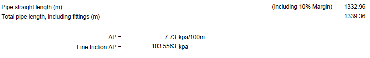

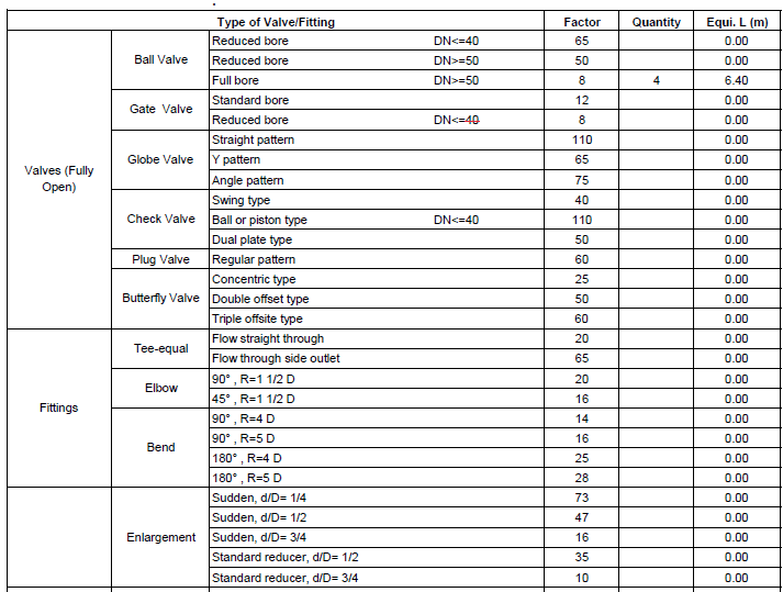

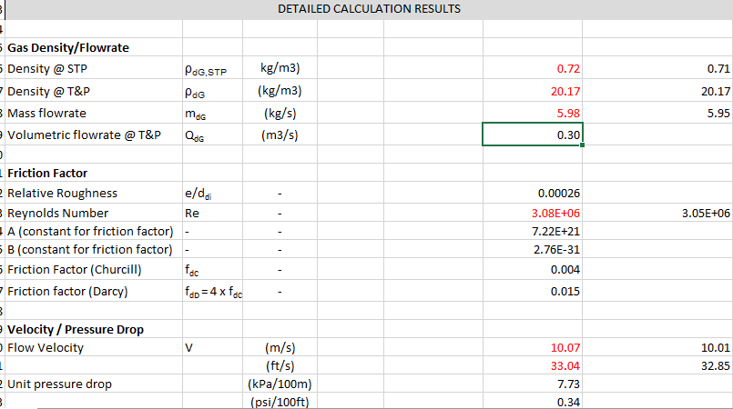

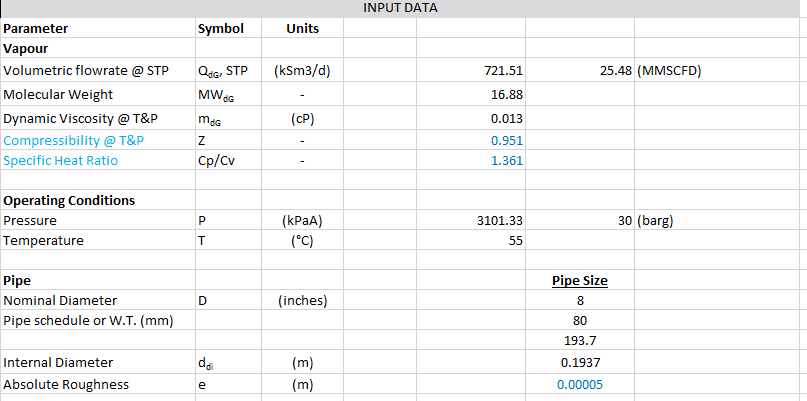

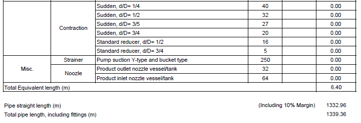

Hi,
I want to ask how to calculate the length of pipeline..From what i have searched, one of the way to calculate it is from the equation of pressure drop. However, it seems i don't have info about the pipe length and pressure drop (it means i need to calculate it). Is it possible to calculate the pipe length without those two info?
As in the attachment are the type of parameter may related to calculate the length of pipeline
Regard,
Mirul

What are you actually trying to calculate, and what are you given?

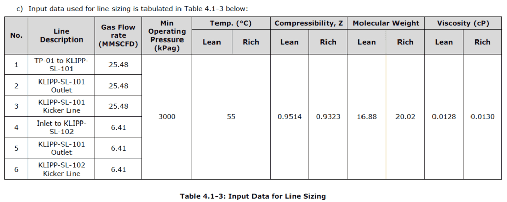

i want to calculate the line friction and i believe in order to calculate it i need the length of pipeline.
On the other side, the input are gas flowrate, pressure, temperature, molecular weight, compressibility and viscosity. However, i really doubt molecular weight, compressibility and viscosity are input and need to be calculate too.
What is your definition of the "pipe friction", the shear stress at the wall? Or is it the pressure gradient times the length of pipe?
