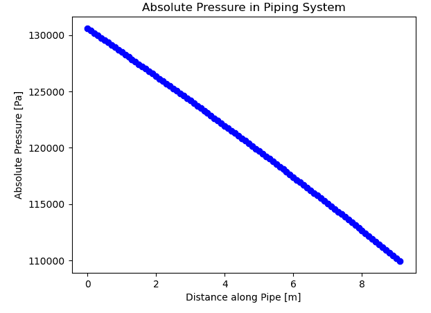

I did figure out how to calculate the change in temperature caused by a pressure drop. For the adiabatic case, you can assume constant enthalpy. The enthalpy, combined with the absolute pressure, are two states that can be used to lookup an associated temperature value at each point along the pipe length. According to my calculation, you will actually see a slight temperature drop as the pressure drops due to the fluid expanding. My code assumes constant enthalpy, which would represent the adiabatic case (insulated pipe). Using the CoolProps module in Python enables the properties to be updated at each "node".

pressure_drop=pressure_array[-1]-pressure_array[0]
temperature_drop=temperature_array[-1]-temperature_array[0]
print('pressure drop total: '+str(round(pressure_drop))+' Pa')
print('temperature drop total: '+str(round(temperature_drop,2))+' K')
print(pressure_array)
The output shows a total temperature drop of 1.16 K and a pressure drop of 20645 K.
The plot of the pressure is shown below:
