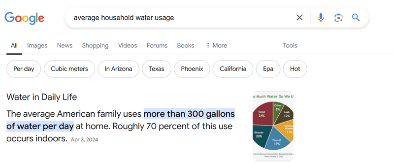

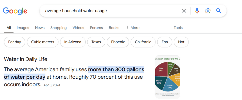

chrblhjj said:
The water will be used for household.
I need like 100 liters per hour. (Approximate daily consumption being 2400 liters).
Is this a lot for a well? It sounds like a lot.
It is small. Mortgage companies want to see recovery rates of 2 gal/min or more from a well. 100liters/hr = 0.43 gal/min. A small family can do ok with that but needs to conserve reasonably and a cistern is often required. Private wells often have recovery rates of 10 to 100 gal/min (38 to 380 lpm = 2280 to 22,800 liters per hour)
I don't get how the numbers in the last couple of posts make any sense.
If a well can't supply 100 liters an hour it's next thing to dry in my opinion. That's only 26 gallons an hour.
Are you talking about the unit conversions (maybe mistakes were made) or about the comparison with your reference? There are large variations in water usage. One hint is where the link says that 70% of use is indoors. To me, that means it is dominated by apartment dwellers who do not water lawns, plant crops, have animals, or fill swimming pools. Private wells in the country are quite different.
I know people (4 adults) who just moved onto a farm (no crops) where the well produces (recovery rate) about 460 gallons per day and there is a large cistern. They also have 5 goats and 4 dogs. They are conscientiously trying to conserve water. They still have to bring in tanks of water regularly.
Assuming a pump combined with a well with a recovery rate of at least 2 gal/min:
$$\frac{300 \frac{gal}{day}}{2\frac{gal}{min}} = 150 \frac{min}{day} \equiv 2.5 \frac{h}{day}$$
So the pump would be required to work at most 2.5 h/day to get 300 gal/day. I'm not sure what doesn't make sense about all these numbers.
Don't forget about average vs peak water use.
i.e. Watering lawn, Taking shower, Running dishwasher, Washing car
All at the Same Time!
Cheers,
Tom
Yes. Even if the average gives plenty of water, it may not support the required peak rate unless water is stored in a cistern.
