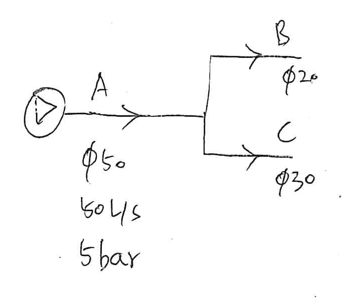

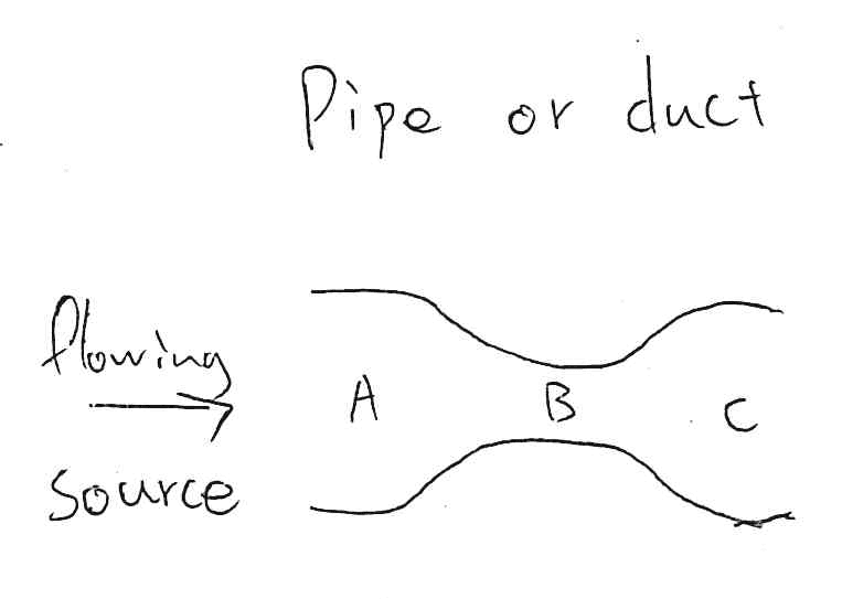

For above pipe or duct flowing (where point A and C are higher diameter than B), same volume flow for point A,B & C.
Velocity B > Velocity A & C ; Pressure energy A > Pressure energy B ; friction pressure B > friction pressure A.
Question one: When pipe or duct sizing to be reducing even re-increasing afterward, the pressure will always drop down and never increase again in the same system without power addition in midway of system?

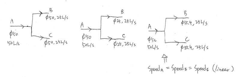

As I known, the flow rate will be averagely divided to the same size of pipe or duct.
Question two: Could we calculate the volume flow rate & pressure for point B and C which only know size?
(assume the source provides steady and constant power, same length of branch pipe or duct, elbow and fluid: water, constant temp. etc)
1. No. Energy is conserved (not pressure). Energy is a function of pressure and velocity.
2. Yes.

Thank you for your help. erobz :) Really appreciated.
$$ \begin{array} \, \frac{P_A}{ \gamma } + \frac{V_A^2}{2g} = \frac{P_{A'} }{\gamma} + \frac{V_{A'}^2}{2g} + k_A ( Re, L , D) \frac{V_{A'}^2}{2g} \\ \frac{P_{A'} }{\gamma} + \frac{V_{A'}^2}{2g} = \frac{P_B}{\gamma} + \frac{V_B^2}{2g} + k_B( Re, L , D) \frac{V_B^2}{2g} \\ \frac{P_{A'} }{\gamma} + \frac{V_{A'}^2}{2g} = \frac{V_C^2}{2g} + k_C( Re, L , D) \frac{V_C^2}{2g} \\ Q_A = Q_B + Q_C \end{array} $$
Would you mind helping to solve the above question two by some steps? As I am not much sure to apply for the equation properly... (you could take assumption for unknown values) Thank you so much!:bow:
Well for starting we are going to need to know the following information:
  1. Is the fluid "incompressible" like water
  2. What is the fluid (does it have a known viscosity )?
  3. Pipe lengths in all sections
  4. Discharge pressures at the end of sections B and C
  5. Are there specific fittings that we need to know about in a given section of the pipe, elbows, tees, reducers, valves, etc...

1. It is water
2. take 20oC temp. Dynamic viscosity of water (in mPa.s) is 1.
3. 10meters for 50mm dia. iron pipe(take same pipe roughness) ; 10m for 20mm dia. iron pipe ; 10m for 30mm dia. iron pipe. they averagely branching to same elbow and not other fitting or valves.
4. assume the water keep flowing and don't know the afterward piping structure and branching, could we know the pressure at point B and C? Or, end of sections B and C is to air (1 atm)
5. a tee 50mm to 20mm/30mm pipe fitting, same elbow and not other fitting or valves
Thank you for your help:)
Without out a pressure gauge at the desired location, No. The flowrate, and pressure will depend on what is downstream in the piping system in each branch.
This criterion can be solved, and is a good first system to get into.
Are there any elevation changes in the pipes relative to the main supply line ( the one bringing in 50 L/s)?
erobz said:
Without out a pressure gauge at the desired location, No. The flowrate, and pressure will depend on what is downstream in the piping system in each branch.This criterion can be solved, and is a good first system to get into.
no elevation changes, thanks.
Fair warning: This is going to be a little bit of work. However, for this example since you've given us the Flow Rate, it won't actually be terribly difficult. We are not going to get into the iteration of a linearized system, but it will still be instructive.
Alright, can you set up the equation between the inlet of branch A and the Tee junction using the relationship?
You will assume the flow is turbulent and thus "approximately" the velocity is uniformly distributed over the pipe cross sectional area.
Hence:
$$ Q_a = V_a A_a $$
*Remember the equation is applicable between any two points ( sections ) along the length of the pipe. For this demonstration, we are going to assume that the head loss coefficient is a constant. So for branch A:
$$ k(Re,L,D) = k_a $$
The goal here will be to determine the pressure at the "T" junction.
I forgot to mention the pressures here are gauge pressures, so ##P_{atm} = 0 \, \rm{guage}##

I will set the equation like this: right?
How to put values on the below equation? What is K value? (I don't know how to transfer to head form) Is it size of pipe and viscosity relating to kinetic energy head so that K x v2/2g?
Not like that. The equation describes the flow properties between any two points. You have three points considered in what you have shown above.
You have to do this in steps. Image you are a water molecule: Jump into the flow at A, where do you go first before a choice must be made on the remainder of your journey?
We will worry about values later.
$$ \frac{P_1}{ \gamma} + z_1 + \frac{V_1^2}{2g} + h_p = \frac{P_2}{\gamma} + z_2 + \frac{V_2^2}{2g} + h_t + \sum_{1 \to 2} h_L $$
