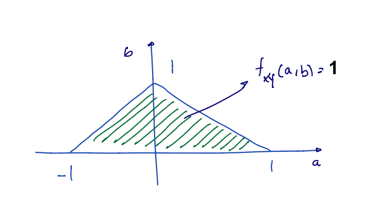

Text reading: The joint pdf f_XY(a, b) is zero outside the triangular region shown below and is equal to a fixed number γ on the triangular region. Answer the following questions about this joint pdf:
Hand-drawn sketch of a triangular region in the a-b plane with vertices at a = -1, a = 1 and b = 1 on the b-axis, shaded in green and labelled f_XY(a,b) = 1.
Text reading: (d) Define Z = X^2. Calculate the joint CDF F_{Z,Y}(a, b).
$$f_{XY}=1$$
$$dzdy=2xdxdy⇒\frac{1}{2\sqrt{z}}dzdy=dxdy$$
$$f_{ZY}=\frac{1}{2\sqrt{z}}\quad \text{on some region S}$$
$$F_{ZY}=\int^y_{g}\int^x_{h}\frac{1}{2\sqrt{z}}dzdy\quad\text{for some}\quad g(x,y),h(x,y)$$
im learning how to find the region S using a change-of variables technique
The integration region for the joint CDF ##f_{ZY}## is always ##z<a## and ##y<b## by definition.
However, there is no real need to make the change of variables here in the first place. You can just integrate in the xy variables. (This is where you need to be careful with your integration region!)
Edit: Another complication in the change of variables is that your change of variables is not a bijection. There are two x values corresponding to the same z value for all ##x \neq 0##.
because i get confused easily, i shamelessly copied the change of variables technique on this link i found on Goggle.
$$f_{ZY}=\frac{1}{2\sqrt{z}}\cdot f_{XY}\quad \text{on}\quad 0<z<(1-y)^2, 0<y<1$$
where ##\frac{1}{2\sqrt{z}}## is the absolute value of the Jacobian determinant and ##f_{XY}=1##. the region was determined using the inverse transforms ##x=\sqrt{z}## and ##y=y##.
is this okay to find the joint CDF by integrating over a square although the region S is not a square? $$F_{ZY}=\int_0^x\int_0^y\frac{1}{2\sqrt{z}}dzdy$$
or is it more like this because I'm supposed to include the boundary information somewhere in the integral?
$$F_{ZY}=\int_0^y\int^x_{(1-y)^2}\frac{1}{2\sqrt{z}}dzdy$$
