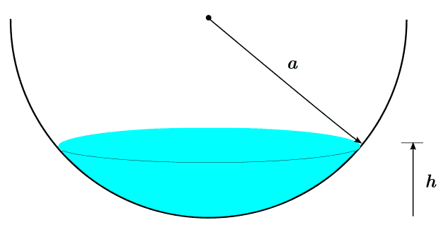

If a liquid fills a hemispherical bowl of radius ##a## to a height ##h##, show that the volume of the liquid is ##\boxed{V = \dfrac{1}{3}\pi h^2(3a-h)}##. (See figure below).
1. The equation of a sphere of radius ##a## : ##x^2+y^2+z^2=a^2##.
2. Volume is given by the triple integral : ##\displaystyle{V = \int\int\int dx \,dy \,dz}##
3. The volume of a cylinder of radius ##r## and height ##h## is : ##V = \pi r^2 h##
Diagram of a spherical bowl with cyan liquid pooled at the bottom. A point marks the sphere's centre, with a line labelled a running from it to the liquid's surface edge, and a vertical arrow labelled h marks the height of the liquid.
Drawing : The drawing of the problem is shown alongside.

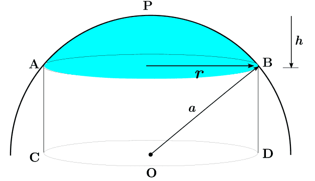

This is also known as the problem of the "spherical cap". I have been able to do it by the normal way. It involves taking a thin slice of the liquid of thickness ##dz## at a height (or depth) ##z## from O and calculating its area ##A = \pi r^2(z)##, where ##r^2(z) = a^2-(a-z)^2##. Integrating this gives the volume : ##\displaystyle{V = \int\limits_{a-h}^h A\,dz}## and it gave the answer above in ##\boxed{\text{box}}##.
Diagram of a hemisphere with a spherical cap of liquid shaded cyan at the top, points P, A, B, C, D and O labelled, radius a from O to B, cap radius r at height h, and a cylinder ABDC below the cap.
The issue : How to do the problem using the method of triple integrals ?
I draw the situation of the problem alongside, naming some points and flipping the diagram horizontally for convenience. The volume of the water is the spherical cap. This can be found by subtracting the volume of the cylinder ABDC from the volume of the dome APBDC : ##V_{\text{liquid}}\text{(APB)} = V_{\text{dome}}\text{(APBDC)} - V_{\text{cylinder}}\text{(ABDC)}##.
The radius of the liquid surface at the point ##h## is ##r = \sqrt{a^2-(a-h)^2}=\sqrt{2ah-h^2}\qquad {\color{blue}{(1)}}##

Your integration region makes no sense. Consider what happens with the y-integral when z = a …
brotherbobby said:
(I) Volume of the dome APBDC : Using triple intgrals,
##V_{\text{dome}}\text{(APBDC)}= \int\limits_0^a dz\hspace{-1em}\int\limits_{-\sqrt{r^2-z^2}}^{\sqrt{r^2-z^2}}dy\hspace{-1em}\int\limits_{-\sqrt{r^2-z^2-y^2}}^{\sqrt{r^2-z^2-y^2}}\hspace{-1em}dx\quad\small{\text{(Note the use of}\, r\,\text{the radius of the cap at}\, h)}##
Is that correct? The 'dome' APBDC consists of two parts with different shapes (spherical cap and cylinder). There is a discontinuity where they meet. A single integral can't handle that.
If you want the volume of a cap using a triple integral, use spherical coordinates.
EDITED. The above is wrong, hence struck-through. See Post #4.

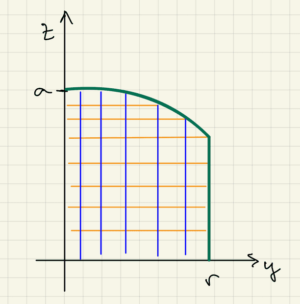

So here is the basic issue. I restricted it to two coordinates as drawing in 3D tends to get messy:
Hand-drawn 2D region on grid paper with z axis vertical and y axis horizontal; a dark green arc starts at z = a on the z axis and curves down to the point (r, z) on the right, with a vertical edge down to the y axis at y = r; horizontal orange and vertical blue lines fill the region.
When doing the z-integral last you must express the bounds on ##y## as a function of ##z##. The lower bound is zero, but the upper bound has two different expressions depending on ##z## (note that it is still continuous though - the derivative is not continuous). Doing the ##z##-integral last corresponds to doing the integral along the yellow lines (i.e., the ##y##-integral) first.
You could perfectly well write down the triple integral using a single region in Cartesian coordinates, but this would require doing the ##z##-integral first, i.e., first integrating along the blue lines. In that case the upper bound of the region is well described by a single function ##z(y)##.
It should also be pointed out that the method mentioned as the "normal way" also relies on a triple integral, just that two of the integrals have already been performed.

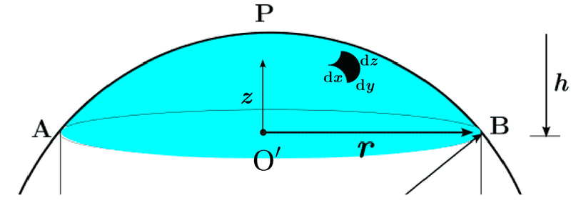

Sorry for coming in late, though I must admit that I am still in dark over this problem. Let me copy and paste the drawing. I am required to find the volume of the "spherical cap", region APBA.
I have done the problem using ##\displaystyle{V = \int\limits_{a-h}^h A\,dz}##, where ##A=\pi r^2(z)##, ##r(z)## being the radius of a slice of the cap at an arbitrary height ##z## and ##dz## the thickness of the slice. ##\color{green}{\Large\checkmark}##
The issue : I tried a different method, where ##\small{V_{\text{liquid}}\text{(APB)} = V_{\text{dome}}\text{(APBDC)} - V_{\text{cylinder}}\text{(ABDC)}}##. I believe I was right in post#1 above finding the volume of the cylinder but not the dome APBDC.
I could follow the posts above, but they didn't help me find the answer, which is ##\small{\boxed{V = \dfrac{1}{3}\pi h^2(3a-h)}}\quad{\color{green}{\Large\checkmark}}##.
I'd like to change tack and try calculate the volume of the cap directly again, but this time use the method of triple integrals. (I will return to the problem of finding the volume of the dome after am done with this, which I suspect will be easier).
Cross-section diagram of a spherical cap in cyan, with apex P at the top, base endpoints A and B, centre O' on the base, radius r from O' to B, height z measured upward from O', cap height h marked on the right, and a small black volume element labelled dx, dy, dz.
It's good to draw the diagram again. I put it to the right. The center of the base of the cape is ##\text O'##. I take an element at a height ##z## from the base, of dimensions ##dx, dy, dz##.
The volume of the spherical cap ##\small{\displaystyle{V = \int\limits_0^h dz \int\limits_{-\sqrt{z^2-r^2}}^{\sqrt{z^2-r^2}}dy \int\limits_{-\sqrt{z^2-y^2-r^2}}^{\sqrt{z^2-y^2-r^2}}dx}}\qquad{\color{blue}{(4)}}##
I'd like to take this slowly. Is equation ##(4)## above on the right track, specially given the integral limits?

Equation (4) makes no sense to me. The radius ##r## depends on ##z##. Moreover, if you put ##z = 0##, you can see that the limits of your integral are not valid.
I am sorry. Yes I should correct it but any hints how they should run?
Put an angle ##\theta## at the centre of the sphere and relate ##h## to the radius ##r(h)## using trig.
Don't you think the radius of the sphere ##a## should appear somewhere in your expression for ##V##?
