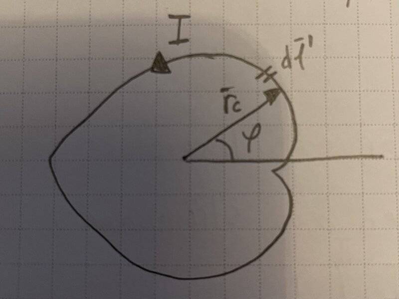

A thin wire that carries the current I is bent in a heart-shaped curve according to the equation r_c=r_0 e^k|phi| for |phi|<= pi, where r_c is the distance from origo to a point on the curve. Calculate the magnetic flow B in origo.
Biot Savarts Law
Hi,
So I know I am to use Biot Savarts law dB= (my_0/4pi)* (I dl x (r-r')/|r-r'|^3 where r=0 because its in origo and r'=r'_c(r'_hat).
This makes (r-r')= -r'_c(r'_hat) and |r-r'|^3= r_c^3.
From previous questions, I have defined dl' as the infinitesimal displacement of r'(phi) when phi' is increasing with dphi along the curve.
Usually its dl'/dphi = r_hat --> dl= r_hat dphi and then I use Biot Savarts law. However I get wrong result here.
My professor tells me to use dl=r_c' dphi' phi_hat + dr'_c r_hat_c.
Why is this intuitively correct? I am having some problem wrapping my head around this. How can I derive it from the dl' expression? Or know if there are any other shapes that do not only depend on phi.

Hi @JoelKTH. I'd like to add to what @berkeman and @haruspex have said.
Your use of primed and unprimed variables is confusing. For example, it is not clear what you mean by dl and dl’. I suspect there is only one line element length to consider, not two. A diagram showing the various vectors and angles might help.
It looks like your professor is telling you to treat the ( vector) line element (dl) as the sum of 2 components: one component in the 'phi-hat' direction and the other component is in the 'r_hat_c' direction. But without a proper diagram showing the vectors and angles, it's hard to know if that's correct.
Yes, I think due to the symmetry of the wire
I would like to add that there is a tip in the solution to go to kartesian coordinates.
$$\frac{d \mathbf{r'_c}}{d\varphi'} = \frac{d}{d\varphi'} (\mathbf{\hat{x}} \cos{\varphi'} + \mathbf{\hat{y}} \sin{\varphi'}) = -\mathbf{\hat{x}} \sin{\varphi'} + \mathbf{\hat{y}} \cos{\varphi'} = \mathbf{\hat{\varphi'}}$$
$$d\mathbf{l'} = \left(\mathbf{\hat{r_c}} \frac{d \mathbf{r'_c}}{d\varphi'} + \mathbf{r'_c} \frac{d \mathbf{\hat{r_c}}}{d\varphi'}\right)d\varphi'$$
Does this make more sense than using $$\mathbf{dl'} = r_c' \hat{\mathbf{\varphi'}} d\varphi' + dr'_c \hat{\mathbf{r'_c}}$$

As I wrote in post #3, I have no idea where you get ##\vec {dl}=\hat r d\phi## from. That makes no sense to me. As @Steve4Physics noted in post #4, your professor's version looks to be based on writing the length element vector as the sum of a radial component and a tangential component, ##\vec{dl}=dr.\hat r+r.d\phi.\hat \phi##, which is clearly correct.
Thanks for your reply. Yes the ##\vec {dl}=\hat r d\phi## is wrong. Instead it normally should be: ##\vec {dl}=\hat \varphi d\varphi##. Due to cylindrical symmetry(no heart shape) ##\vec {dl}=\hat r d\phi##.
But now its heart-shaped. I suppose it makes more sense that if the radius is not constant, an infinitesimal movement around the wire should then also be dependent on the radius. Which most likely is the ##r.d\phi.\hat \phi## part. I think this is where I am confused and perhaps its more a question of vector calculus than physics.
After studying my Mathematics Handbook of 600 pages that contains vector component relationship, I see the the patter. Thanks for your help
No, that can't be right either; it's dimensionally wrong. You have a length on the left but not on the right.
For constant radius it would be: ##\vec {dl}=r\hat \varphi d\varphi##.
Since the radius changes too, there is also the vector due to the radius change: ##\hat r.dr##.
Hence, in general, ##\vec {dl}=\hat \varphi r.d\varphi+\hat rdr##.
If ##r=r_0e^{k\varphi}##, can you express ##dr## in terms of ##d\varphi##?

Differentiate ##r=r_0e^{k\varphi}##.
##r=r_0ke^{k\varphi}##
No, that's incorrect differentiation. You have to pick what it is you are differentiating with respect to and do it consistently both sides.
If I differentiate wrt phi: ##\frac{dr}{d\phi}=r_0ke^{k\varphi}##, which I can rewrite as ##dr=r_0ke^{k\varphi}d\phi##.
You are now in a position to find ##\vec dl## in terms of ##\phi, d\phi## and the unit vectors.

Why do you insist on using all these primes (‘) in your notation? Don't you get fed up typing them? I don't see what the c subscript gains either.
To avoid blunders, we should consider ##\phi>0## and ##\phi<0## separately.
We have for positive ##\phi##:
##r=r_0e^{k\phi}##
##dr=kr_0e^{k\phi}d\phi##
##d\vec l= \hat\phi r.d\phi+\hat rdr##
Can you combine those to eliminate r, i.e. to obtain ##d\vec l## as a function of the two unit vectors and ##r_0, k, \phi, d\phi## only?
Similarly, write ##\vec r## in those terms and compute ##d\vec l\times\vec r##.
