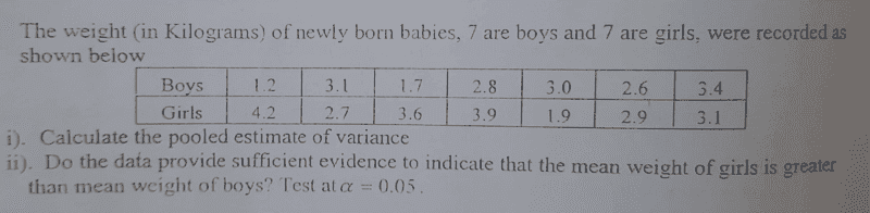

See attached

OK, Let me attempt part (i), first,
Here we have;
##s^2_p ##=##\dfrac{ (n_1-1)s_1^2+(n_2-1)s_2^2}{n_1+n_2-2}##
##s^2_p ##=##\dfrac{ (7-1)0.63953+(7-1)0.6148}{7+7-2}##
##s^2_p ##=##\dfrac{3.83718+3.6888}{12}##
##s^2_p ##=##\dfrac{7.52598}{12}##
##s^2_p ##=##0.627165## its located between the two original variances... correct? i do not have markscheme nor solutions...

i) Your sample sizes are uniform, so there's no need for weighted averages here. Find the variance estimates for both populations and then take their arithmetic mean.

Ok mate i.e ##\dfrac {0.63953+0.6148}{2}##= ##\dfrac {1.25433}{2}=0.627165## .
For part (ii), Let, ##μ_1## and##μ_2## be the mean for boys and girls respectively, then
We want to test the hypothesis; as per the question...
##H_0##: ##μ_1##=##μ_2## - Mean weight of boys is equal to mean weight of girls.
##H_A##: ##μ_1##<##μ_2## - Mean weight of boys is less than the mean weight of girls.
Using the t-statistic and also considering that dof =##12##and ##α=0.05## then it follows that the critical value = ##-1.782##
We shall therefore have,
##t##=##\dfrac {2.5429-3.18571}{\sqrt{(0.627165^2(\frac {1}{6}+\frac {1}{6})}}##=##\dfrac {2.5429-3.18571}{0.256040263}##=##-2.5105 < -1.782 ## We thefore Reject the Null hypothesis and accept the Alternative hypothesis.
Your notation is overloaded. You likely mean ##\mu _1## for boys and ##\mu _2## for girls. Hypotheses are logical negations of one another. This is not the case right now.

Amended ...sorry was a bit busy...

Is it now correct?
