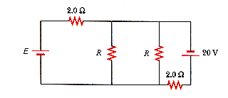

Here is the accompanying diagram.
Calculate the power delivered to each of the resistors in Figure P28.28 (E = 55 V, R = 5.0 .)
  1. ____W (2.0 resistor in loop with 55 V source.)
  2. ____W (5.0 resistor in loop with 55 V source.)
  3. ____W (5.0 resistor in loop with 20 V source.)
  4. ____W (2.0 resistor in loop with 20 V source.)
Kirchhoff's Rules
ƩIenter - Ʃleave = 0
ƩEmf - ƩIR = 0
http://dl.dropbox.com/u/9172399/Pictures/001.jpg I basically broke the problem into the six loops and wrote equations based on the loop rule. I've never encountered anything near as complex as this, so I'm at a loss of what to do...
How does the point rule work in this case with so many currents? Did I draw the currents in the right direction? I haven't the slightest idea...

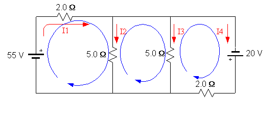

You only need enough loops so that all of the components are traversed by at least one. So in this case you can get away with three loops. Your loops designated I, II, and III would suffice.
The directions that you assume for the currents won't matter so long as you follow the rules about potential drops occurring in the direction of assumed current flow as you go around the loops.

Sorry, I don't see where you're handling the current in the final branch (with the 20 V source). There should be four branch currents, one for each branch:
That makes I1 = I2 + I3 + I4.
You could also write a single KCL node equation and then find the currents using the node voltage.

Alright, here's another attempt...
I1 = ~ 18.0
I2 = ~ 1.79
I3 = ~ 1.79
I4 = ~ 14.5
What I did might work or I might have done something illegal...
I took
55-7I2-2I3-2I4
-20 -5I3+2I4
-5I2+5I3
added them and got
35 - 12I2 -2I3 = 0
and then solved for I3
I3 = 12.5-6I2
Then I substituted that into
-5I2 + 5I3 = 0
and got my answers...
I've never solved for 4 variables, so I'm kinda grasping at straws.
Your equations look fine, but your solutions are off.
How about these?
I1 = 18.0
I2 = 3.8
I3 = 3.8
I4 = 10.5
bodkin.thomas said:
How about these?
I1 = 18.0
I2 = 3.8
I3 = 3.8
I4 = 10.5
Nope.
Let's take your equations:
55 - 7I2 - 2I3 - 2I4 = 0
-20 - 5I3 + 2I4 = 0
-5I2 + 5I3 = 0
Note that the last equation implies that I2 = I3. So replace I2 in the first equation with I3, and discard the last equation since it's served its purpose. You're now left with two equations in two unknowns:
55 - 9I3 - 2I4 = 0
-20 - 5I3 + 2I4 = 0
continue...
