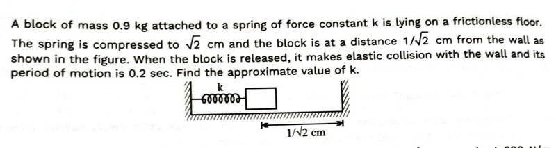

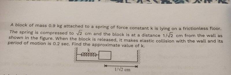

Block of mass 0.9kg. Spring(k) on frictionless floor. Spring compressed to ##\sqrt 2##cm. Block at ##1/\sqrt 2##cm from wall. Collision is elastic and time period of motion 0.2s. Approximate value of k?

Yes the question does say all collisions are elastic. See the image for full question

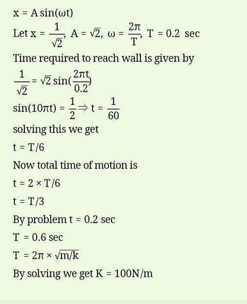

These are the only two solutions I found on the web but I can't make heads or tails of these:
Thats ##k=100\pi^2/9## btw

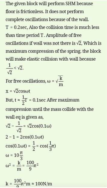

Solution 2
Does it mean the book might have given a wrong answer or I am misinterpreting the question ?
The first solution is what I did. The second solution looks like nonsense to me.

Me too. The key here is to realize that the distance from the initial position of the mass to the wall is ##\frac{3}{2}A## where ##A## is the amplitude and then find the time required to cover that distance as a fraction of the unobstructed period of oscillations.

Why do you think this means the book's answer might be wrong? Both answers agree with the book.
Do you understand the first solution?
The second solution is unintelligible because it seems to use T to mean two different things.

Here's an equivalent problem. The spring is compressed by ##\sqrt 2##cm and the mass is released. The time taken to move an initial distance of ##\frac 1 {\sqrt 2}## cm from the point of release is measured as ##0.1##s. What is the spring constant?

Try my alternative problem:

That's good. That's the first aspect of the original problem.
The second aspect of the original problem was to recognise that the motion after the collision was the reverse of the initial motion. Then, you can justify that ##t_1 = t_2 = 0.1s##. And, you can do the calculation you just did.
There are several ways, I guess, to see that the elastic collision with the wall simply reduces the motion to the initial and final stages of what would have been the full SHM.
Solution 1) above doesn't give a justification, as far as I can see. What would be your explanation?
