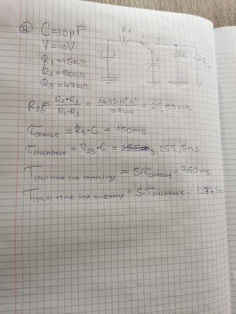

Is the capacitor C= 10μF in the circuit unpolarized or polarized? When the switch is in position (1), the capacitor is charged, and when it is in position (2), the capacitor is discharged. Determine the time required to fully charge the capacitor and the time required to fully discharge the capacitor. It is known: V= 10 V, R1= 15 kΩ, R2= 56 kΩ, R3= 7 kΩ
None
I really don't get this one. Why do I need V? Since I didn't use it, I assume my work Is incorrect.
Handwritten circuit calculation on lined paper: C = 10 µF, V = 10 V, R1 = 15 kΩ, R2 = 56 kΩ, R3 = 47 kΩ, with a switch circuit diagram, R23 = 25.55 kΩ, and time constant and full-time calculations for charging and discharging.
Seems like a trick question; are you sure you copied it exactly? It takes an infinite amount of time to "fully" charge or discharge a capacitor (that's the nature of the exponential funtion).
Also, please learn to use LaTeX to post math equations. There is a link to the "LaTeX Guide" below the Edit window. Thank you kindly. :smile:
It looks like they are using the ##5\tau ## approximation.
Ahh, the old ##5\tau## approximation for ##\infty## -- got it. :wink:
You don't need V as long as the criteria for "fully" is a percentage of V, as with the 5τ approximation, which is essentially a 99% done criterion.
