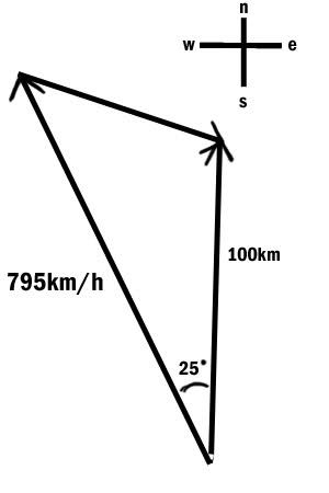

1. How long will it take a plane to travel 100km [N] if its ground velocity is 796km/h [25 W of N]
I am having the hardest time with question since I actually don't know how to start. I know it require the fomula T= V*D. I manage to get a diagram but that is far as I gone. =(
Help? I have a final tomorrow and I need to able to do this kind of questions.
It is an odd question. Are you sure you weren't given any information about the wind speed and direction?
As it stands, I would say you are just asked to find the vertical or north component of the vector. That is 795*cos(25). And use that speed in d = vt where d is 100 km to find the time.
I quoted it word for word, that is all your given =(
