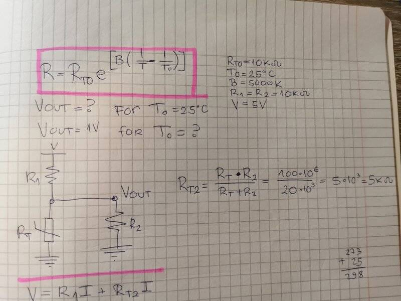

If RT0= 10 kΩ, T0= 25°C, B= 5,000 K, R1=R 2= 10 kΩ, and V=5 V, determine the value of voltage V OUT at temperature T0. When the temperature changes, the measured voltage value is V OUT = 1 V. Determine the value of the unknown temperature. Ignore the change in resistance of resistors R1 and R2 with temperature.
On the paper
Is my work correct?
You know what you wrote, but I cannot accurately read your photographs, so I cannot efficiently check your work. Maybe it is time you typed in your work or used LaTeX.

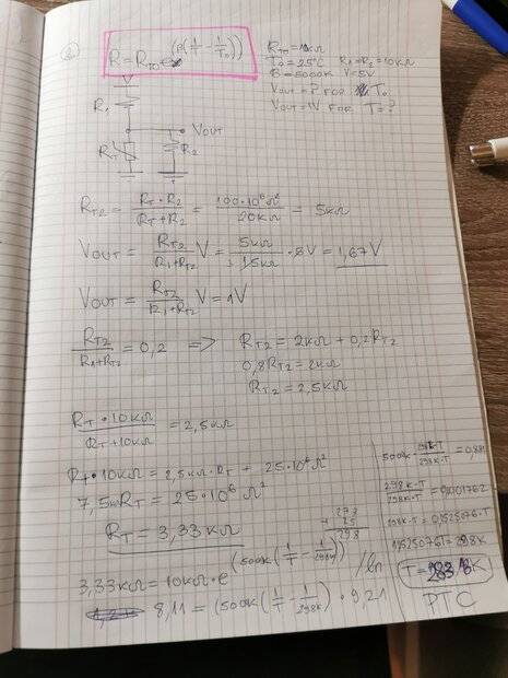

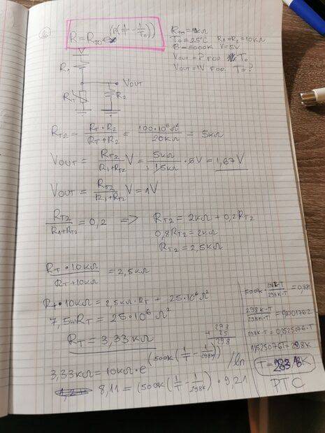

I always end up making some mistake when doing these problems so I am worried. And I am not really interested in being this type of engineer, it's just a class I have to pass in my cs course.
The Homework Statement says B= 5000 K and in the photgraph I read B=500. I may be mistaken because my eyes aren't what they used to be.
It Is 5000. I forgot one 0 and then i wrote it so it's a lot less noticable but the problem is solved with 5000.

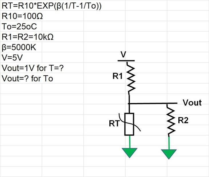

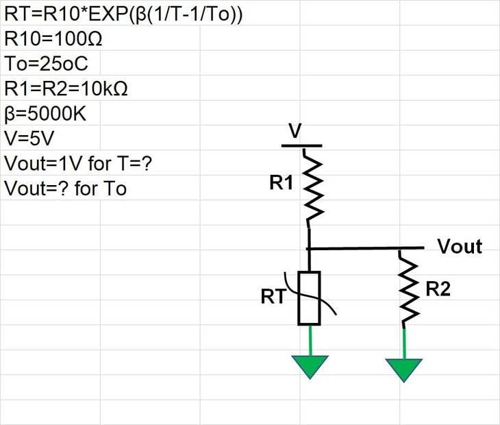

I hope you will agree with me, it is very difficult to read your draft. I made a large copy to see better.
In my opinion, it must be what is in my second image - if you agree.

Hopefully this Is better.
I Got a different result so I might have made a mistake previously too.
I got the same result so I think it is ok.
