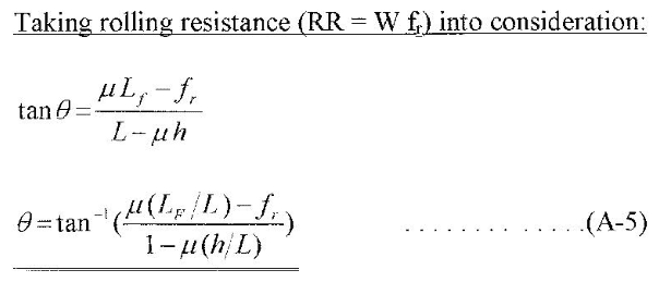

Ok, I used the steps described in that document, without Fa and RR, because there is no rolling, and no speed?
Is this correct?

And in up motion, I will use this for calculating the max angle.
And one more question, the calculation from that document, are valid for an angle smaller than maximum angle?

I am not sure about those equations.
Could you show us what the terms mean and a free body diagram of forces?
Right here, in my case FWD.
Thank you.
I do not see the ##F_r## that is shown in the equations in that diagram.
Do you want to find the torque of each wheel as a function of those variables for your work rather than calculating a value for a determined slope?
Yes, I want to find the torque of each wheel as a function of those variables.

But we are calculating for steady condition first: no rolling resistance.

Yes, you could once you are ready to compute the dynamic condition of the car moving uphill.
For static conditions, the equation for finding the angle is correct, being ##f_r=0##
That would be the maximum angle for which your driven wheels will keep traction.
The torque that each of both driven wheels should deliver in order to keep the car from rolling backwards should be equal to half the total weight (0.5 mg) times the sin of the angle of the slope times the radius of the wheel.
