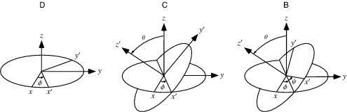

Hello, I'm sorry if this is a dumb question but I am extremely confused and could use some guidance.
So consider a cartesian coordinate system with a plane which passes through the origin, and there are vectors of known X,Y,Z components which lie within this plane. The plane(and vectors) are then rotated about the X,Y, and Z axes by some unknown angles wrt the origin. Assume that the plane is initially parrallel with the XY plane and has a rotation about Z of 0
Given the new coordinates of the vectors after rotation, is there a way to algebraically determine the angles of rotation Rx, Ry, and Rz that were applied?
My original approach was based on finding the planes unit normal vector (N), then calculating Rx = atan(Ny/Nz) and Ry = atan(Nx/Nz), and using one of the vectors (V) to calculate Rz = atan(Vy/Vx), but I am realizing this is incorrect. Is this even possible? Thanks for taking a look.

Thank you both for your responses. I think my part of my confusion is because I want the transformations to occur about the original coordinate system.
Looking at the image from the wolfram site:
The final transformation appears to be taken about the rotated coordinate systems z axis (the angle ψ), also appearing in this text below:
1. the first rotation is by an angle phi about the z-axis using D,
2. the second rotation is by an angle theta in [0,pi] about the former x-axis (now x') using C, and
3. the third rotation is by an angle psi about the former z-axis (now z') using B.
What I want are rotations about the original coordinate system (xyz), i.e. \thetax, \thetay,\thetaz which yield the rotated points.
I am wondering if this is due to the definition of rotation being a coordinate system transformation vs. a transformation of the points themselves. From what I have gathered from the wikipedia article on rotation matrices, switching the sign of the sin terms in the rotation matrix yields a point transformation vs. a coordinate system transformation. However, isn't this irrelavent as it is really just the idea of rotation by a negative angle vs. a positive one? (i.e. -20 degrees coordinate system transformation is equivalent to +20 degrees point transformation)
Of particular interest however were equations 71-77 of the wolfram math page, and funny enough was an solution I originally conceived but then disregarded.
Essentially given X as an original point and X' as the rotated counterpart due to applied rotation transformation A, (i.e. X' = AX), you can use a nonlinear iterative solution method to solve the applied rotations.
So if A = R_x*R_y*R_z (where R_x is the rotation matrix of some angle about X, then the Jacobian of A with respect to \thetax, \thetay,\thetaz can be used to solve the rotations that occurred.
Thus my question is this: Using the iterative solution outlined above (see the wolfram math page at this link, and using the rotation matrices outlined in this wikipedia article, will the solution give me rotations \thetax, \thetay,\thetaz about the original coordinate system xyz?
Worded another way, if I were to take some points and apply a three transformations (R_x,R_y,R_z), all of these rotations should be occurring about the "same" coordinate system, i.e. coordinate systems with identical orientation, correct?
I hope this makes sense, thanks for all your help and let me know if you need any clarification.
