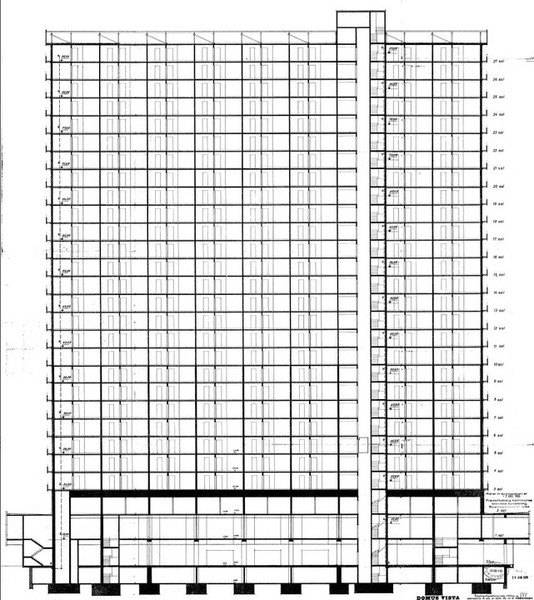

Bjarne
344
How can i calculate the Acceleration Due to Gravity expected to be measured
  • At the bottom of the building, - for example at Ground Floor or in the cellar.
  • And at the top of the building.
The weight is about 55.000.000 KG.
The is height 96 meter
Width = 20 meter
Lenght = 20 meter
This is not homework

Why do you expect it to be different? To what accuracy do you intend to make this calculation? And what is the application?
g at 96 metres is the same as g at 0 metres, to many decimal places.

Calculate for your given mass at the centre of mass of your building, then, and subtract it from g. You will need many significant figures, though.

Shape is irrelevant, or at least its effect is another several orders of magnitude smaller. You can treat the building as if it is a point-source of gravity.
i.e.: The presence of the building on g will make a difference of maybe 10^-6. The shape of the building will make a difference on g of maybe 10^-9. (These are ballpark magnitudes, just to give you an idea.)
Actually, I was being over simple. The gravitational potential of a cuboid is not the same as that of a sphere but you would certainly get a good idea of the magnitude of the force if you just went for a point mass at the cm particularly as it is so tall and thin!
Gravitational acceleration is subject to the superposition principle. Calculate the gravitational acceleration due to the Earth and the building separately and just add. The Earth is fairly easy: Use the free air correction for points above the ground floor or a double negative Bouguer correction for the basement.
Gravitation due to the building is an exercise left to the OP. A Bouguer-style correction might give a reasonable approximation.

The shape of the building (or any other object) makes a big difference, according to how strong ADG you can expect a certain place, near or on the top of the building.
So I am asking about which equation to use to calculate ADG near, or on the top of any kind of building structure..
For exsample , how would you calculate ADG of the building mentioned above...if you were standing at the roof.
