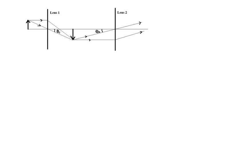

1. An object is placed 1.5m in front of a convex lens of focal length 500mm. Find the position of the image formed and state its nature.
2. A second convex lens of focal length 25mm is placed 770mm behind the first convex lens. Find the position of the final image formed and state whether the image is real or virtual.
3. Find the angular magnification for the final image if it is formed at infinity.
1.[itex]\frac{1}{u} + \frac{1}{v} = \frac{1}{f}[/itex]
[itex]\frac{1}{1500} + \frac{1}{v} = \frac{1}{500}[/itex]
[itex]v = 750mm[/itex]
[itex]m = \frac{-v}{u} = \frac{-750}{1500} = -0.5[/itex]
Image is Real as v > 0
Image is Diminished as |m|<1
Image is Inverted as m < 0
2. [itex]\frac{1}{u} + \frac{1}{v} = \frac{1}{f}[/itex]
[itex]\frac{1}{20} + \frac{1}{v} = \frac{1}{25}[/itex]
[itex]v = -100[/itex]
Image is virtual as v < 0
3. This is the part I don't know how to do. Any advice would be appreciated.
You can define angular magnification as
[itex]M_A=\frac{tanθ_1}{tanθ_2}[/itex]
Where θ1 is the angle subtended by the first image at the first lens and θ2 is the angle subtended by the second image at the second lens.(Check out the attachment)
Under what condition is the final image at infinity?
  • Ray diagram of a two-lens system: an upright arrow object on the left, Lens 1 and Lens 2 drawn as vertical bars, an inverted arrow between them, and rays with angles labelled θ1 at Lens 1 and θ2 at Lens 2.
