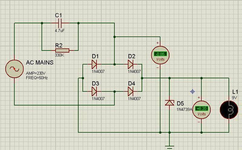

Here is the schematic.. further circuit is not here. input supply is 230V AC 50Hz as per our country specifications.
Simulation is done in ISIS Proteus 8.0
Yikes. I see several problems here. Where did you get this circuit? Can you link to the original source? Overall, this circuit makes no sense, IMO.
For example, you have a 50Hz AC Mains source trying to charge a 20uF capacitor through a 470nF capacitor. Do you see any issue with this (and there is the series resistor problem adding to this problem)...?
Oh, I see—you included it because I mentioned surge current? But you can't make it an arbitrary value—the current through that path becomes the current for the DC side of your power supply. Because you haven't shown what circuits this will be supplying, I can't guess how much DC current it needs to supply. Have you estimated the DC current your loads will draw?

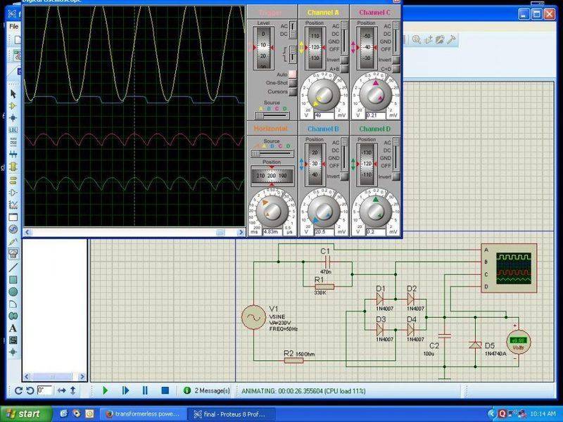

check this image. and look at the output waveform.
Is it ok? or should i make some changes here also?

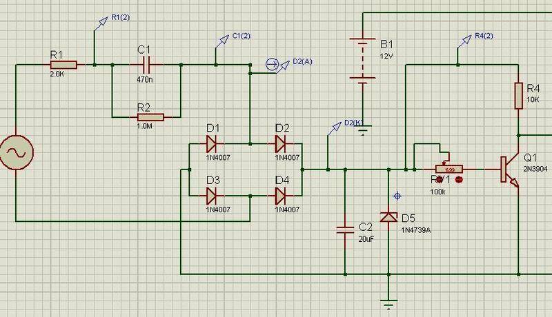

You may not understood previous diagram as there was transistor and battery of 12Volt shown. the simplified diagram is here. you can check this. is that ok? or still have some problems?
No, it still has errors and makes no sense. Why are you insisting on putting a capacitor in series with the AC Mains input? I can think of no reason in this circuit to do that. And you appear now to have deleted the input storage capacitor. Why?
The capacitor is there as a low-heat (i.e., low energy-loss) voltage-dropping impedance. This is standard design of this type of low-power transformerless power supply. A voltage-dropping resistor can be used instead, but this is substituting one problem with another: dealing with the heat that resistor produces.
The design itself is a compromise, and is not suitable for applications where a user could come in contact with any part of the power supply or the devices it powers. Opto-isolation is desirable in achieving this.
