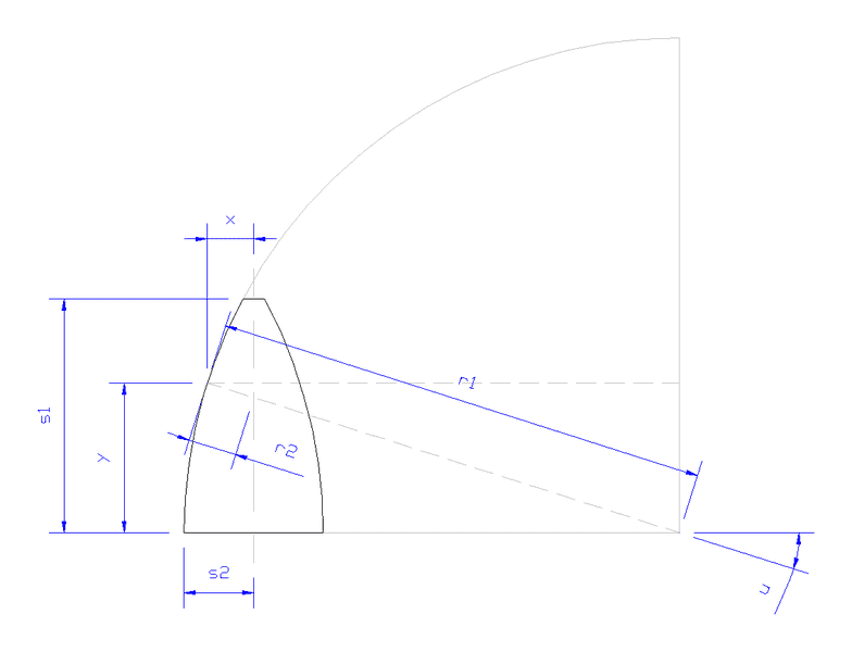

I am trying to find the centre of mass of a projectile nose. I profoundly suck at integration, but I have managed to work out area, and now I'm battling centre of mass. Am I doing this correctly? Is my final integral correct?
[tex]x = \sqrt{r_{1}^{2} - y^{2}} - (r_{1} - s_{2})[/tex]
[tex]\int{x \;\delta y} = \frac{y}{2}\sqrt{r_{1}^{2} - y^{2}} + \frac{r_{1}^{2}}{2} \cdot \tan^{-1} \left( \frac{y}{\sqrt{r_{1}^{2} - y^{2}}} \right) - y(r_{1} - s_{2})[/tex]
[tex]\delta V = 2 \pi \int{x \;\delta y}[/tex]
[tex]s_{"centre"} = \frac{\rho}{m} \int{x \;\delta V} = \frac{2 \pi\rho}{m} \int{x^{2} \;\delta y}[/tex]

Your formula for the center of mass is not quite correct. You have to remember you deal with three dimensional vectors.
[tex]\vec s_{center} = \int \vec r dV[/tex]
For symmetry reasons you will see at once that the center of mass has to be on the axis, i.e only [tex]s_y[/tex] is non zero.
Then you can use your integral from before. Actually this integral will be easier than the one for the total Volume.
I get
[tex]s_y = 2 \pi \frac{\rho}{m}\left(\frac{1}{3} r_1^3 -\frac{1}{3}\sqrt{r_1^2-s_1^2}^3+(s_2-r_1) s_1\right)[/tex]

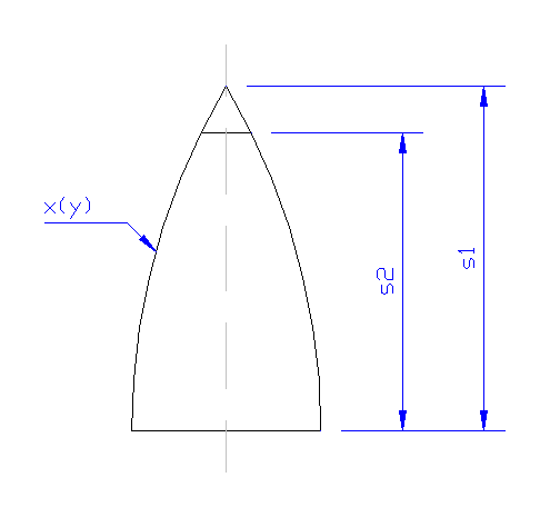

I am making generic formulas for finding volume, centre of mass, angular mass, etc., of circular cones: x(y) being the function of the cone slope, s1 being the maximum possible length of the cone (where the slope intersects the y-axis), and s2 the truncated length (and also truncated at the bottom, but not displayed here: simply int B - int A; where A is 0 for no bottom truncation).
So given x(y), what is the indefinite integral you used to arrive at your final equation?

Your way to integrate is correct. I do it the same way. I just think you got the formula for the center of mass wrong. We have to sort this one out before we can tackle the integrals.
Could you post your formula for the center of mass of a general body? Then we can check.

[tex]x(y) = \sqrt{r_{1}^{2} - y^{2}} - (r_{1} - s_{2})[/tex]
[tex]\delta V = \int A(y) \;\;\delta y = \pi \int x(y)^{2} \;\;\delta y[/tex]
[tex]\delta R_{y} = \frac{\rho}{m} \int y \;\;\delta V[/tex]
...am I correct so far? And this in turn becomes...
[tex]\delta R_{y} = \pi \frac{\rho}{m} \int y \cdot x(y)^2 \;\;\delta y[/tex]
...or would it need to be y(x)? Seems a little redundant...
P.S. I slightly change the equation to use method of disks, handy little thing I just learned. Seemed more logical to me.

The volume element is
[tex]dV = dx\ dy\ dz[/tex]
In our case of an axissymmetricb body it is best to use polar coordinates. In these the volume element is (in your choice of names)
[tex]dV= xd\phi dxdy[/tex]
The factor xcomes from changing the volume element of integration. Probably you are more familiar with the formula written in r and [tex]\phi[/tex] in which case it is [tex]dxdz=rdrd\phi[/tex]
Then the total Volume is
[tex]V = \int_0^{2\pi} d\phi\int_0^{s_1} dy \int_0^{r(y)} dx x[/tex]
Now we can do the integration of the angle which will give a factor 2Pi and the integration for x. This leaves
[tex]V = 2\pi\int_0^{s_1} \frac{1}{2} x(y)^2 dy[/tex]
This integral is nasty to do by hand but fortunately the integral for the center of mass will be easier.
The y-component of the center of mass is given by
[tex]R_y= \frac{\rho}{m}\int_0^{2\pi} d\phi\int_0^{s_1} dy \int_0^{r(y)} dx\ x\ y[/tex]
Again as before this gives
[tex]R_y=\frac{\pi\rho}{m}\int_0^{s_1}dy\ x(y)^2y[/tex]
Inserting the formula for x we get
[tex]R_y=\frac{\pi\rho}{m}\int_0^{s_1}dy\ y\left(r_1^2-y^2-2(r_1-s_2)\sqrt{r_1^2-y^2}+(r_1-s_2)^2\right)[/tex]
Expanding the bracket, multiplying and simplifying we get.
[tex]R_y=\frac{\pi\rho}{m}\int_0^{s_1}dy\ \left(y(2r_1^2-2r_1s_2+s_2^2)-2(r_1-s_2)y\sqrt{r_1^2-y^2}-y^3\right)[/tex]
Now you can evaluate this integral in your favourite program or do it by hand.
The first term is proportional to y, so the integral will give y^2/2. The last prop. to y^3, so integrating gives y^4/4. The middle term looks nasty because of the square root but the additional factor of y in front saves us. You will notice that
[tex]\int y\sqrt{r_1^2-y^2} dy = -\frac{1}{3}\sqrt{r_1^2-y^2}^3[/tex]
Altogether we have
[tex]R_y=\frac{\pi\rho}{m}\left[\frac{y^2}{2}(2r_1^2-2r_1s_2+s_2^2)+\frac{2}{3}(r_1-s_2)\sqrt{r_1^2-y^2}^3-\frac{y^4}{4}\right]_0^{s_1}[/tex]
At the lower limit this is zero. The upper limit gives your desired value.
