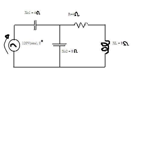

See Attachment.
Find the total Current in the following circuit by phasor diagram techniques only. What is the total power dissipated?Do not use complex #'s.
Im not really sure how to start and the notes for this topic arent that great. I have done a few examples involving a series cct and parallel cct, but I haven't seen one like this.
Any help would be appreciated.
Thanks

So, what is the equivalent phaser resistances for capacitors and inductors? Once you convert your supply to phaser form, and the resistances to phaser form all of the regular circuit techniques can be applied. I am really confused by the "do not use complex numbers" statement. It's like saying, "You must use phasers! Oh, I'm sorry, I meant phasers without complex numbers (?)."
