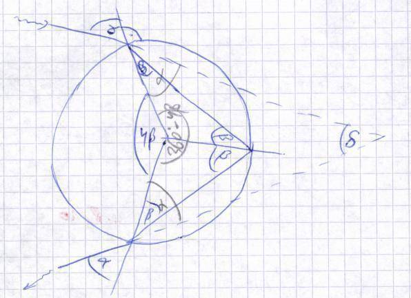

Hi everyone
Let's say we observe a rainbow. We know the refraction index of the red and violet light, let's call them [tex]n_{1}=1.46[/tex]and [tex]n_{2}1.47[/tex] Now I want to calculate the angle [tex]\delta[/tex]
In a square the total angle is 360°, so we have:
[tex]360°= \delta+\alpha+\alpha+(360°-4\beta)[/tex]
and
[tex]\delta= 4\beta-2\alpha=4arcsin(\frac {1} {n} sin\alpha)-2\alpha[/tex]
Thats my attempt thus far, which I wrote down in the relevant equations. I have two unkown variables, alpha and delta and I want to calculate alpha. Is there a way to calculate alpha in order to get delta?
Thanks for your help
What angle are you trying to calculate? Maybe it's just me but it isn't clear to me what angle is in question.
Wow, I failed, I wanted to attach a file, sorry for that. I want to calculate delta, but I need to find alpha first and I don't know how.
