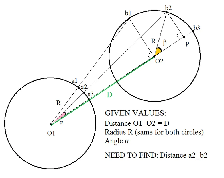

Hello all
I summarised my question on the attached picture
I will wery appreciate if somebody can confirm:
Does my attempt to find distance a2_b2 correct? Is there simplier method?
It is not a homework, It is for my hobby project.
(I want to simulate my robot's sensor readings in some situations)
My attempt:
Step 1. Calculate ## {\angle \beta} ##:
Assume ##{\angle \beta}## is directly proportional to ##{\angle \alpha}## (NOT SURE!)
$$ \frac {\angle \beta} {\angle \alpha} = \frac {\angle b1\_O2\_b3 } {\angle a1\_O1\_a3} $$
$$ {\angle b1\_O2\_b3 }= \frac \pi 2 \text{ , } {\angle a1\_O1\_a3} = \tan^{-1}(\frac R D) $$
$$ {\angle \beta} = \frac {\angle \alpha * \frac \pi 2} {\tan^{-1}(\frac R D)} $$
Step2. Calculate distance O2_p:
$$ {O2\_p} = {R*\cos(\beta)}$$
Step3. Calculate distance O1_p
$$ {O1\_p} = {D + O2\_p} = {D + R*\cos(\beta)}$$
Step4. Calculate distance O1_b2
$$ {O1\_b2} = \frac {O1\_p} {\cos(\alpha)} = \frac {D + R*\cos(\beta)} {\cos(\alpha)}$$
Step5. (Final) Calculate distance a2_b2
$$ {a2\_b2} = {O1\_b2 - R} = \frac {D + R*\cos(\beta)} {\cos(\alpha)} - R \text{, where } {\angle \beta} = \frac {\angle \alpha * \frac \pi 2} {\tan^{-1}(\frac R D)} $$

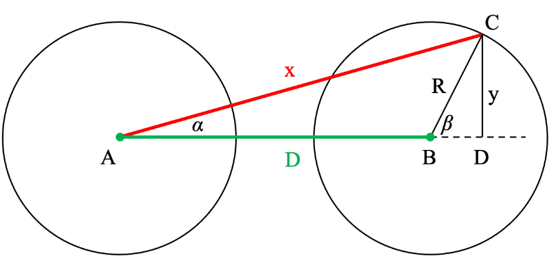

Note that
##y=R\sin\beta=x\sin\alpha.## Angles ##\alpha## and ##\beta## are not proportional.
Then
##\cos\beta=\sqrt{1-\sin^2\beta}=\dfrac{1}{R}\sqrt{R^2-x^2\sin^2\alpha}.##
From the law of cosines for triangle ABC
##x^2=D^2+R^2+2DR\cos\beta \implies x^2=D^2+R^2+2DR\left(\dfrac{1}{R}\sqrt{R^2-x^2\sin^2\alpha}\right).##
Solve the quadratic for ##u=x^2##. Make sure you pick the correct solution then subtract ##R## from ##\sqrt{u}##.
I don’t know if this is simpler but it can be done as the intersection of a line and a circle. Note, I’m using ##x## as the standard coordinate. Referring to @kuruman ’s excellent graphic, If the origin is at A and letting D be along the x axis, the point C is the intersection of the line ##y=xtan(\alpha) ## and the circle centered at ##(D,0)## which is ##(x-D)^2+y^2=R^2##. Solve for ##x## then ##AC=\large\frac{x}{cos(\alpha)}## then just subtract ##R##.
bob012345 said:
I don’t know if this is simpler . . .
If it isn't simpler, it certainly is more elegant.
