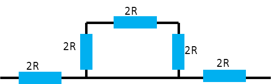

In the given circuit,the equivalent resistance between points A and B will be?
My solution
Effective resistance will be 2Ω+2Ω=4Ω as the current will not enter the triangle as equal amt of current enter from opposite sides(Im not sure about this part)
My solution
Correct !
But why doesnot current enter if opp sides have equal amt of current
Not sure what do you mean by "opp sides". If you redraw the circuit (see attachment), the three resistors short and no current flows through them.

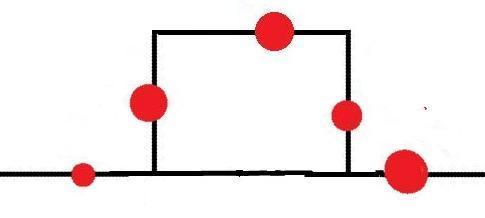

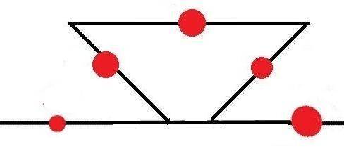

pratyushag said:
Why do the resistors short?
because there is a physical short circuit shown in your original circuit.
The drawing produced by Pranav-Arora is electrically the same as yours just a different physical shape. He's not added any wire or nodes just changed the physical shape of the existing node.
