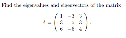

Forgive me for being lazy, but the following seems to be the matrix for which @zak100 is to find eigenvectors
from his pdf.
Then for the eigenvalue λ = 4, we have ##\ (A - 4 I )= \begin{pmatrix} -3 &-3 & 3 \\ 3 & -9 & 3\\ 6 & -6 & 0 \end{pmatrix}## .
This is the matrix described in the OP of this thread as being the matrix for which zak100 is to find eigenvectors, but according to the pdf, he is to find eigenvectors for the matrix, A, in the above screen shot.
(... has been slightly edited.)
View attachment 230735 from his pdf.
Then for the eigenvalue λ = −4, we have ##\ (A - 4 I )= \begin{pmatrix} -3 &-3 & 3 \\ 3 & -9 & 3\\ 6 & -6 & 0 \end{pmatrix}## .
That's the matrix described in the OP of this thread.

Hi,
Thanks for working on my prob. I am extremely sorry that I gave the wrong matrix. Its my fault. Thanks for your time.
Can I use the inverse of a Matrix in this case or Gause Jordan Method is the only solution. Please guide with a link to a simple example of Gauss Jordan Method.
Zulfi.
