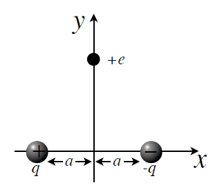

I had this question in my homework:
An electric dipole consists of two equal loads and signs opposite separated by one distance which equals 2a. Show how the module of the electric force resulting on a proton (load +e) placed directly on the Y=axis at a very long distance from the dipole (y>>a) is given by Fe = 2aekq/y^3
The usual equation for the electric force is: Fe= keq/r^2
I tried to replace the distance r^2 with Pythagore: a^2 + y^2 = r^2, but i didnt find the y^3
Could anybody help me?
Is the dipole oriented along the x-axis or the y-axis?
Assuming the dipole is oriented along the x-axis, place charge q at x=a/2 and charge ‒q at x = ‒a/2. Find the vector sum of the force each charge in the dipole exerts on the proton. (The y-components of the two forces should cancel, leaving only the x-components.)

Here is the image of the dipole in question. My issue is how do we actually demonstrate that the module of the electric force resulting on a proton (load +e) placed directly on the Y=axis at a very long distance from the dipole (y>>a) is given by Fe = 2aekq/y^3 (i think I'm just not getting it at all... sorry :S)

  • Diagram of an electric dipole on the x-axis: charge q at x = -a and charge -q at x = +a, with a proton (+e) on the positive y-axis above the origin.

I didn't read closely enough.
Place charge ‒q at x=a and charge +q at x = ‒a, as in the figure.
The force, F‒, on the proton, due to charge ‒q is: F‒= ____ ? (It's a vector.)
The force, F+, on the proton, due to charge +q is: F+= ____ ? (It's also a vector.)
Thank you for your help,
in brief, i only found the vector on the x-axis (cuz as you said the y-component should be canceled) and replaced the sin by tan (because of the very long distance of the y-component of the proton, which was nearly equal to the distance between the proton and one of the chage q). So the tan would be replaced by a/y.
in brief, i only found the vector on the x-axis (cuz as you said the y-component should be canceled) and replaced the sin by tan (because of the very long distance of the y-component of the proton, which was nearly equal to the distance between the proton and one of the charge q). So the tan would be replaced by a/y.
If r2 = a2 + y2, then for y » a, r2 ≈ y2.
That should get you your desired result.
