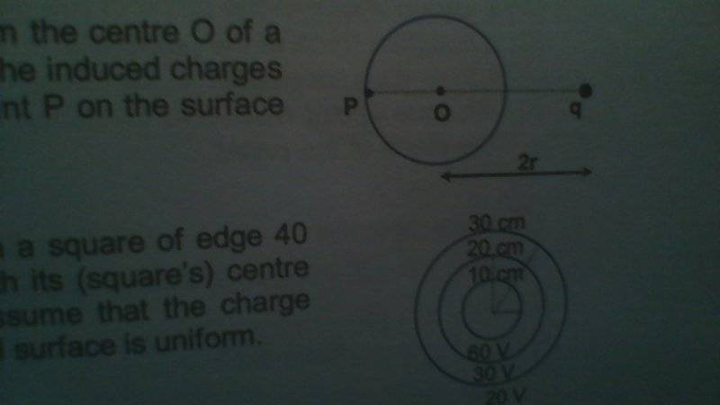

A point charge q is placed at a distance 2r from center O of a conducting charged sphere of radius r .Due to the induced charges on the sphere ,find electric potential at point P on surface of sphere [if Kq/r=18V]
I tried this
at point P
Vnet=Vinduced+Vcharge
now Vcharge=kq/3r
but I cannot find way to calculate Vnet to find Vinduced
Assume a uncharged sphere of radius r and a charge q is kept at distance 2r from center and P is point diametrically opposite to q See second image
  • Diagram of a circle with centre O, point P on its left edge and point q outside on the right along the same horizontal line, with a double arrow labelled 2r from the centre to q; below, concentric circles labelled 10 cm, 20 cm and 30 cm with potentials 60 V, 30 V and 20 V.
Consider an element of induced charge qi on the sphere. Where might it be located? What is its contribution to the potential at the centre of the sphere? What is the total contribution of all such induced charge to the potential at the centre of the sphere?

We need the potential on the surface, not the center, of the sphere.
Only way I know of approaching this problem is via imaging. Are you (the OP) familiar with that technique?
It's a conductor, no internal charges, and OP is first trying to find Vnet at P.
