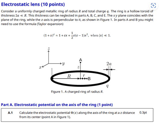

For A.1 of this problem,

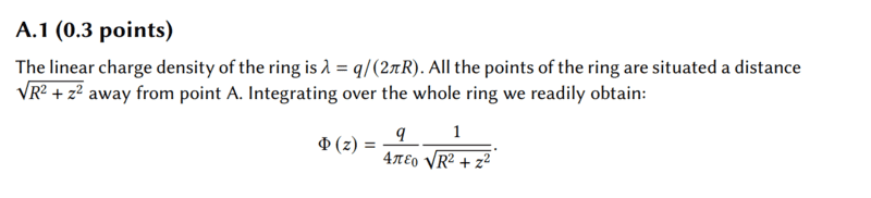

The solution is
However, I have a doubt about the linear charge density ##\lambda##.
I don't understand how ##\lambda = \frac {q}{2\pi R} ## since this is not a thin ring, but has a non-negligible width of ##2a##
I think that the toroid has a larger area than thin circle with a circumference ##2\pi R## so linear charge density should be less than that expression.

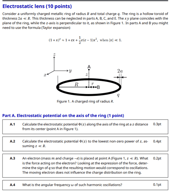

EDIT: How would we calculate the electric potential if the thickness was not neglected?
Many thanks !

Callumnc1 said:
Thank you for your reply @BvU!
However, how would we calculate the electric potential if the thickness was not neglected?
Many thanks!
Since it is metallic, your first challenge would be to figure out the charge distribution. Good luck with that.
Thank you for your reply @haruspex! Yeah that seems hard!
